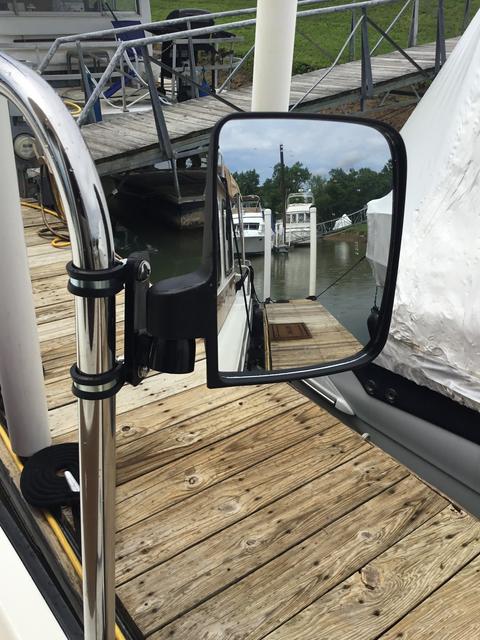

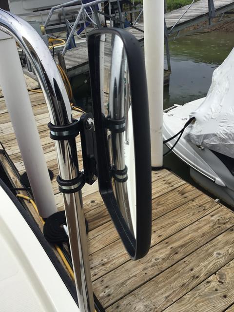

Here’s what I came up with:
https://www.amazon.com/dp/B073YLF753/re ... rd_w=4eYuh
They are designed for use on golf carts, but work very well on a Ranger Tug. I used 1” adel clamps to mount them. There is a slight amount of vibration from the engine, but it does not affect their usefulness. I’m very pleased with the large, clear image.
I really wanted a “fold in” feature for when the boat is in my slip.
