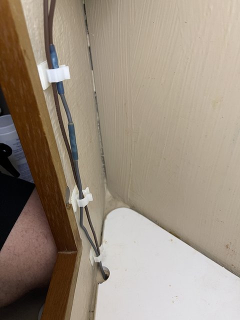

This shows the wiring coming up through the removable floor support and the edge of the removable floor. I may replace the nylon cable clips with flat plastic cable conduit if the nylon clips interfere with what I store in the cabinet. The cable clips for some reason look bigger in this photo.

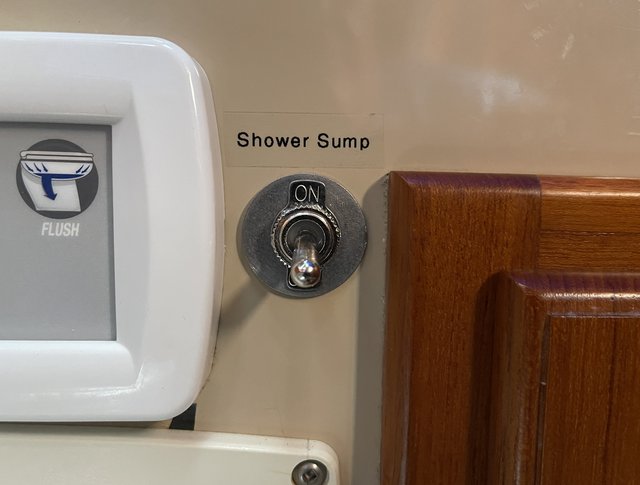

This is where I located the switch. Being a pilot for 40+ years, I can’t stand unlabeled switches.
