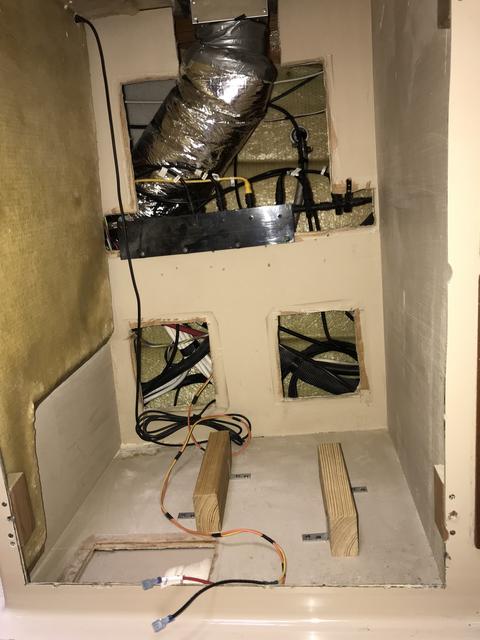

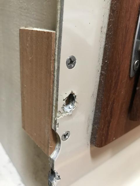

Sometime during a long tow in July, all four sheet metal screws holding the refrigerator to the surrounding fiberglass structure stripped out and the refrigerator popped out of its space a couple inches. I fixed it on that trip by installing larger size screws in the stripped out holes.
I knew it was a temporary fix and the day has come to make a more permanent fix— the bottom two screws have stripped out again and the refrigerator bottom is tilting out about 1/2”. The right way to secure a large, heavy object like a refrigerator would be with bolts and nuts. Sheet metal screws into fiberglass is just a lousy way to secure anything under a load. Unfortunately, I don’t see a good way to use bolts and nuts without removing the countertop for access.
If I go the sheet metal screw route, I will have to remove the refrigerator and drill new holes in the refrigerator perimeter frame for the screws to pass. The existing holes in the fiberglass structure where the refrigerator is located are hopelessly wallowed out and can’t be reused for sheet metal screws. I guess I could make a fiberglass repair at the stripped out holes, but my fiberglass skills are rudimentary. From what I can tell, this isn’t the first time these screws have stripped.
I may investigate fashioning a metal bracket around the existing wallowed out screw holes and install rivet nuts so I can use a bolt.
Has anybody dealt with this problem? I need ideas.
