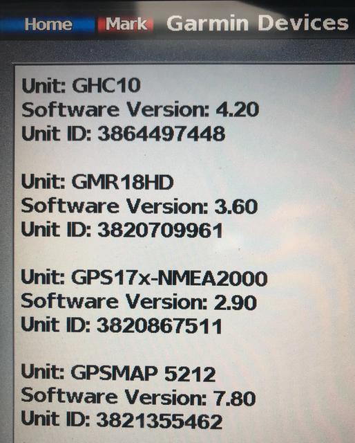

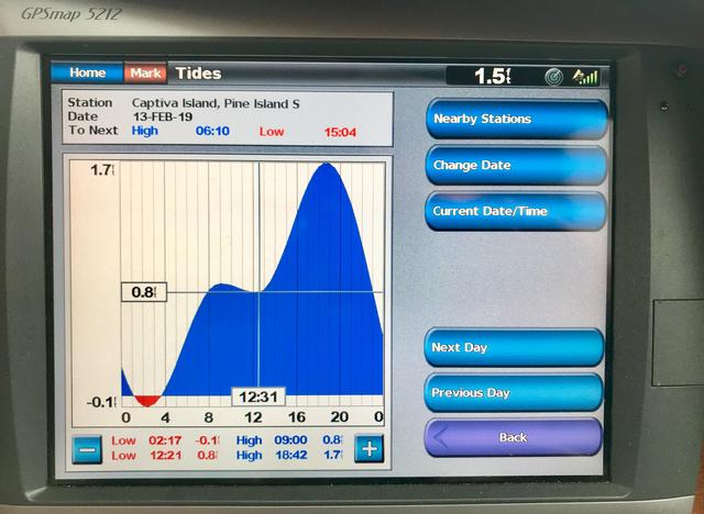

Postby CaspersCruiser on Wed Feb 13, 2019 9:16 pm
Here is a photo of the Garmin devices listed on my 5212. The software version for each is displayed on the second line. My GPS antenna is the GPS 17X-NMEA2000. The software version is 2.90 :
This is a photo of the 5212 tides page taken this afternoon:
The tides displayed on the 5212 mirrored exactly those displayed by the Navionics app on my iPad. Updating the GPS antenna to software version 2.90 has resolved the date issue for my 5212.
