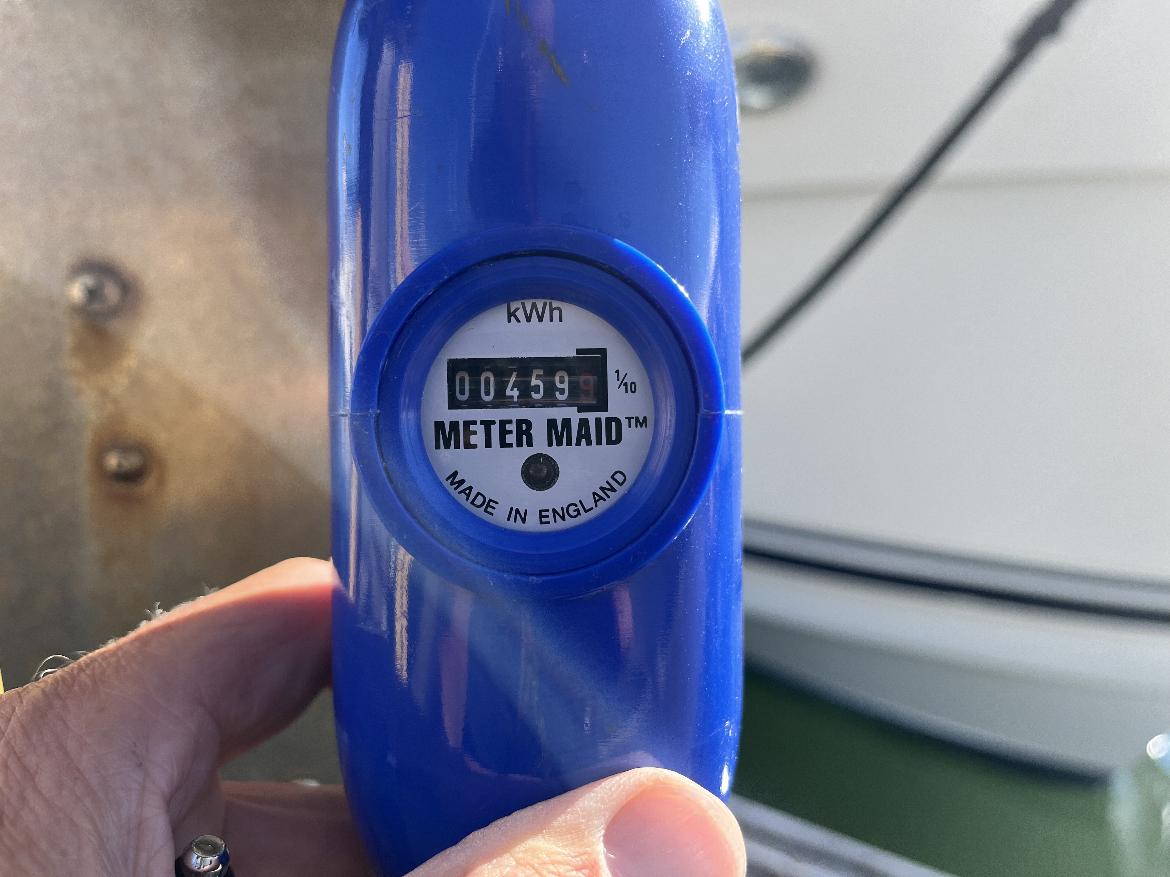

Since I got my C302c in 2019, my electric bill has been less than $10 per month with all the same devices left on: 3 fridges: Main, Bait and Wine. I also have two small dehumidifiers with no fan that draw almost no power.
Last month, I got my slip bill and was amazed that the electric bill was roughly 10x. The harbor attached a Meter Maid and gave me the following report:
The meters were checked last night by our team. Attached are the photos. This is what I gather:
Original pedestal read 8/28/24: 43798.6
Pedestal read 9/5/24: 43815.3
Difference= 16.70
Original Meter Maid read 8/28/24: 442.5
Meter Maid read 9/5/24:459.9
Difference=17.40
The difference between the two readings varies by .70 with the Meter Maid showing the slightly higher read.
According to this test, it looks like your boat is drawing some power.
I'd like to know if anyone has had similar experiences when the power consumption rises 10x and you have not changed anything on the boat...very puzzling.

If the meter reading went from 440 to 44000, that is 100x. If that is kWh, that would be a spendy power bill.
LOL, I took their word for the interpretation of the MeterMaid that reads kWh...terrible name IMO.
