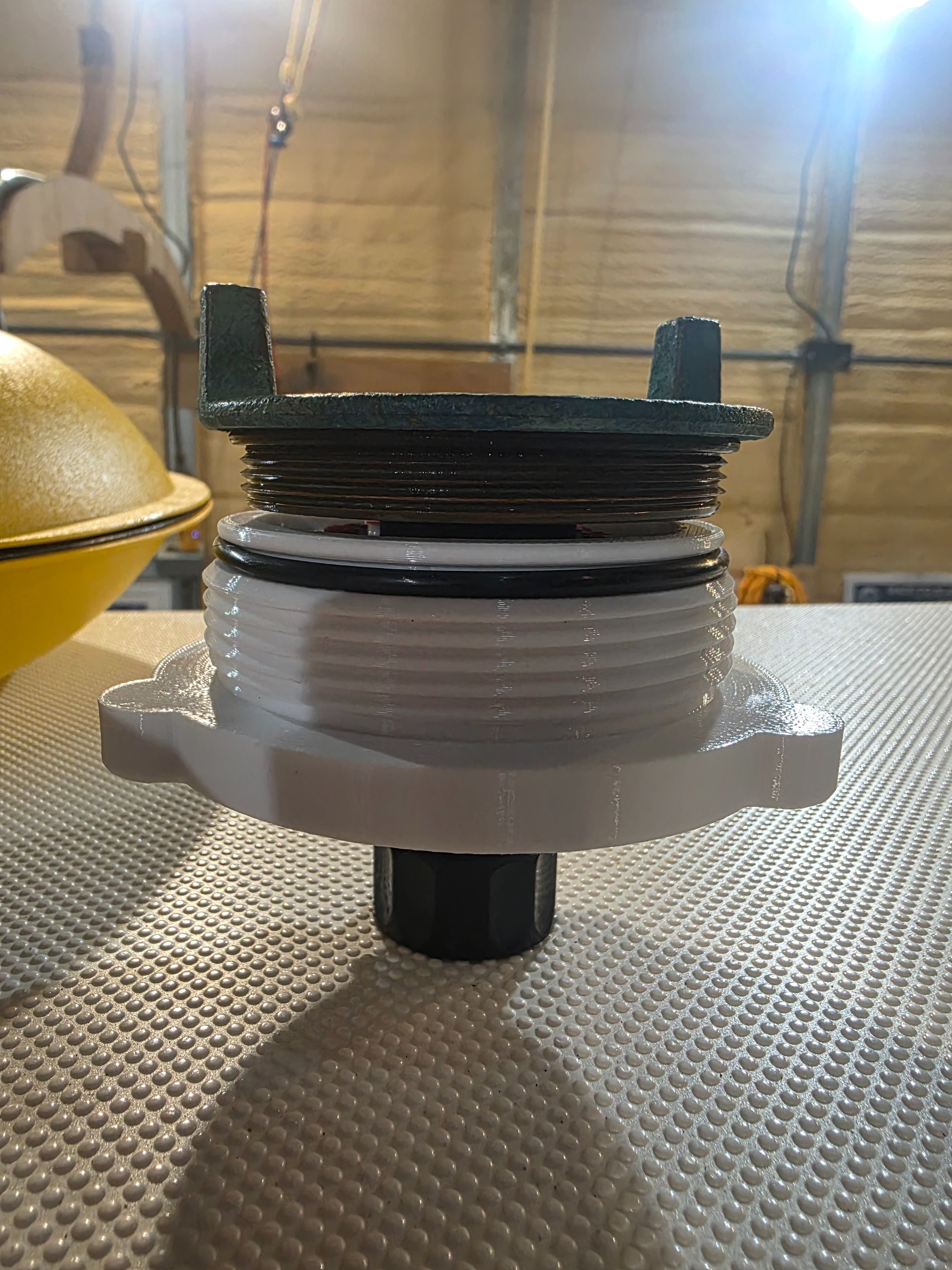

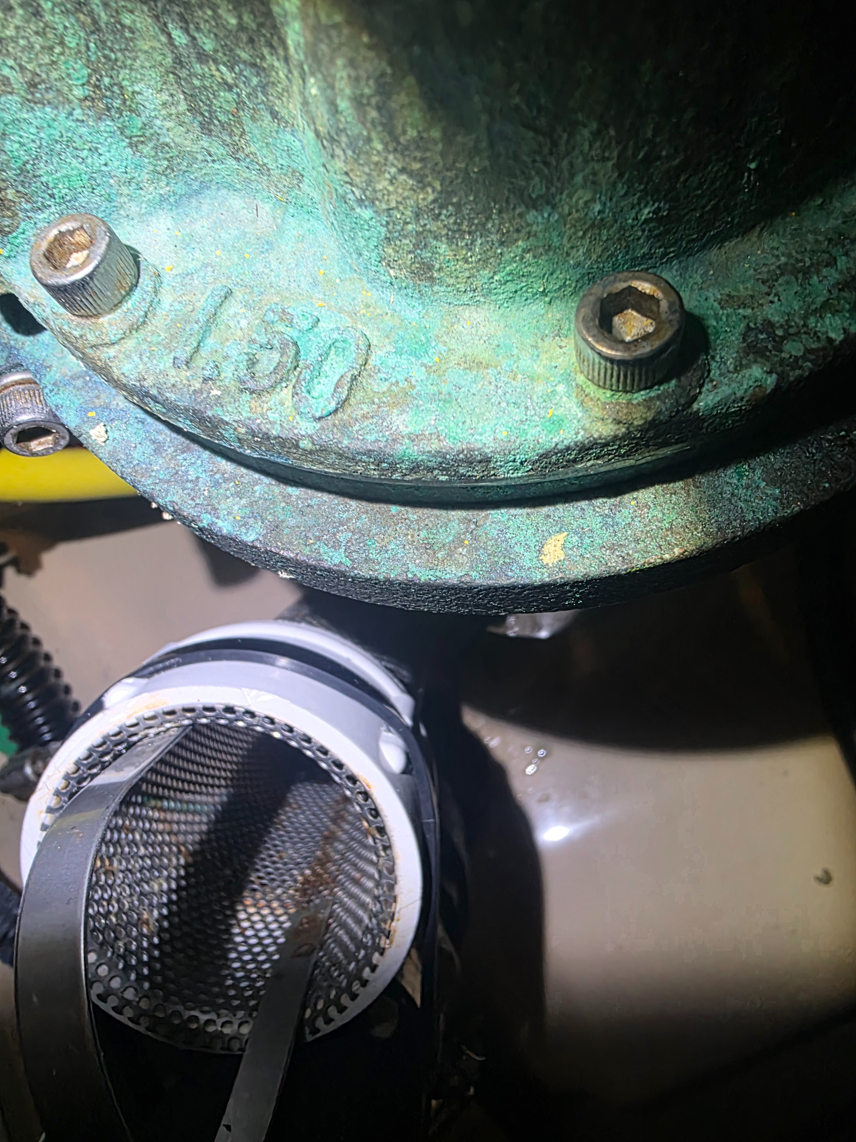

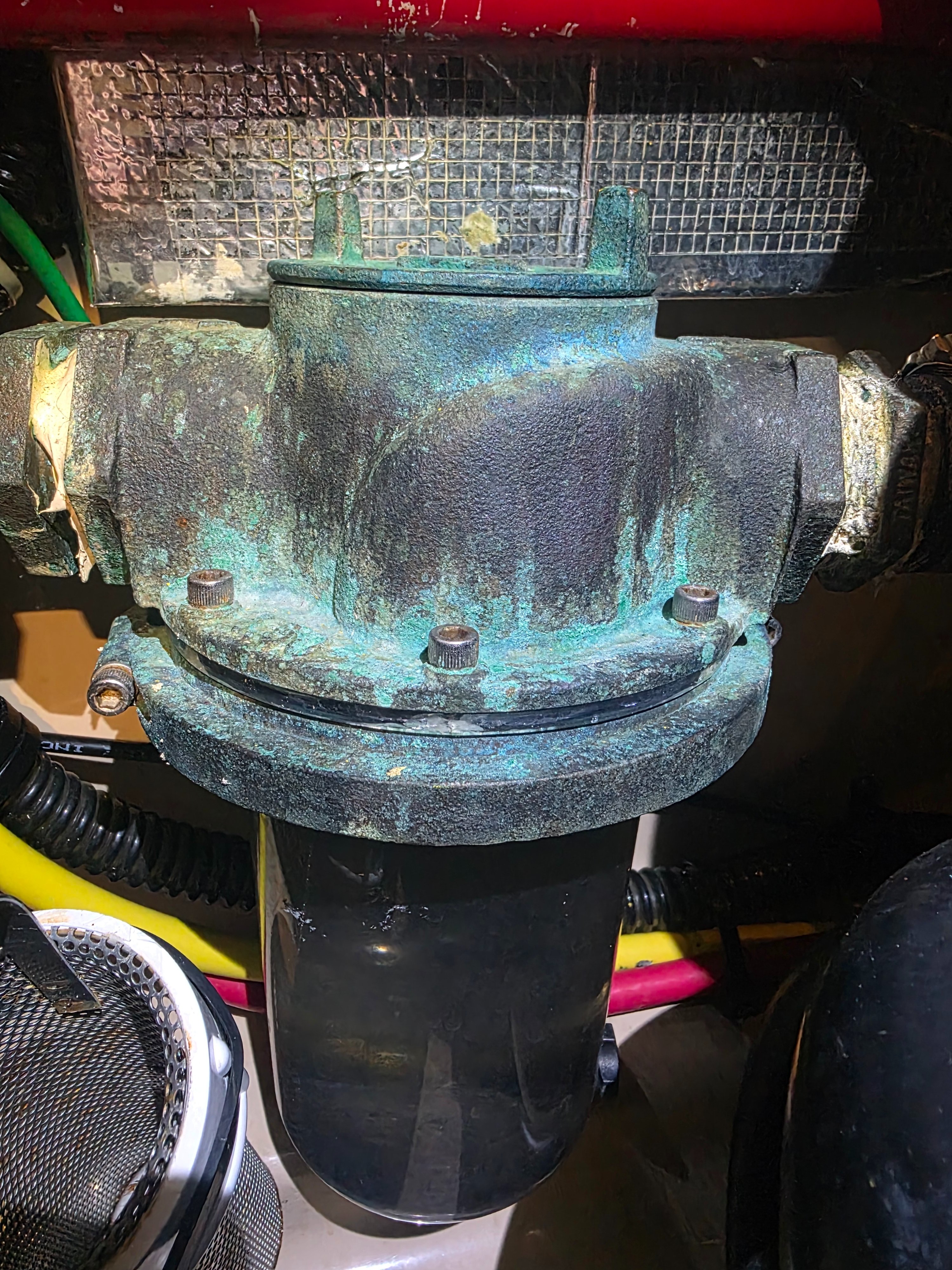

Hi there friends, with nearly 2k hours id like to flush the intercooler with rid lyme using a flushing cap on the raw water strainer. Draw the solution into the motor, shut it down & let it sit for 4 hours or so. The problem is i cant find a flushing cap bc I cannot identify the mfr of the RW strainer. It is not Groco as many builders use but some other brand. OR its an older Groco model? Casting marked "1.5" but a flushing cap for Groco 1500 RWS is too big. Help!!

The strainer is a "Marine Hardware" 1.50 inch.
