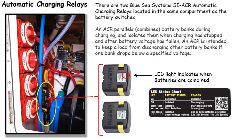

When on shore power the ACRs should open and charge all the batteries and be at the 13.5V float that you see on house/starter. ACRs won't open if the thruster battery is too low, but that limit is 9.5V so 12V is perfectly in range to open up.
If your charger wasn't working then your house/starter wouldn't be showing 13.5V, so I don't think it's a charger issue. I would start by trying to troubleshoot the ACR and make sure all the wiring in tight, including the path from starter battery->ACR->thruster. After that I would look at replacing the ACR, while a 5 year old battery might need to be replaced soon anyways, I don't think that's the issue here.

This is for a newer model R31, but you can check the LED light on the ACR to determine it's status
