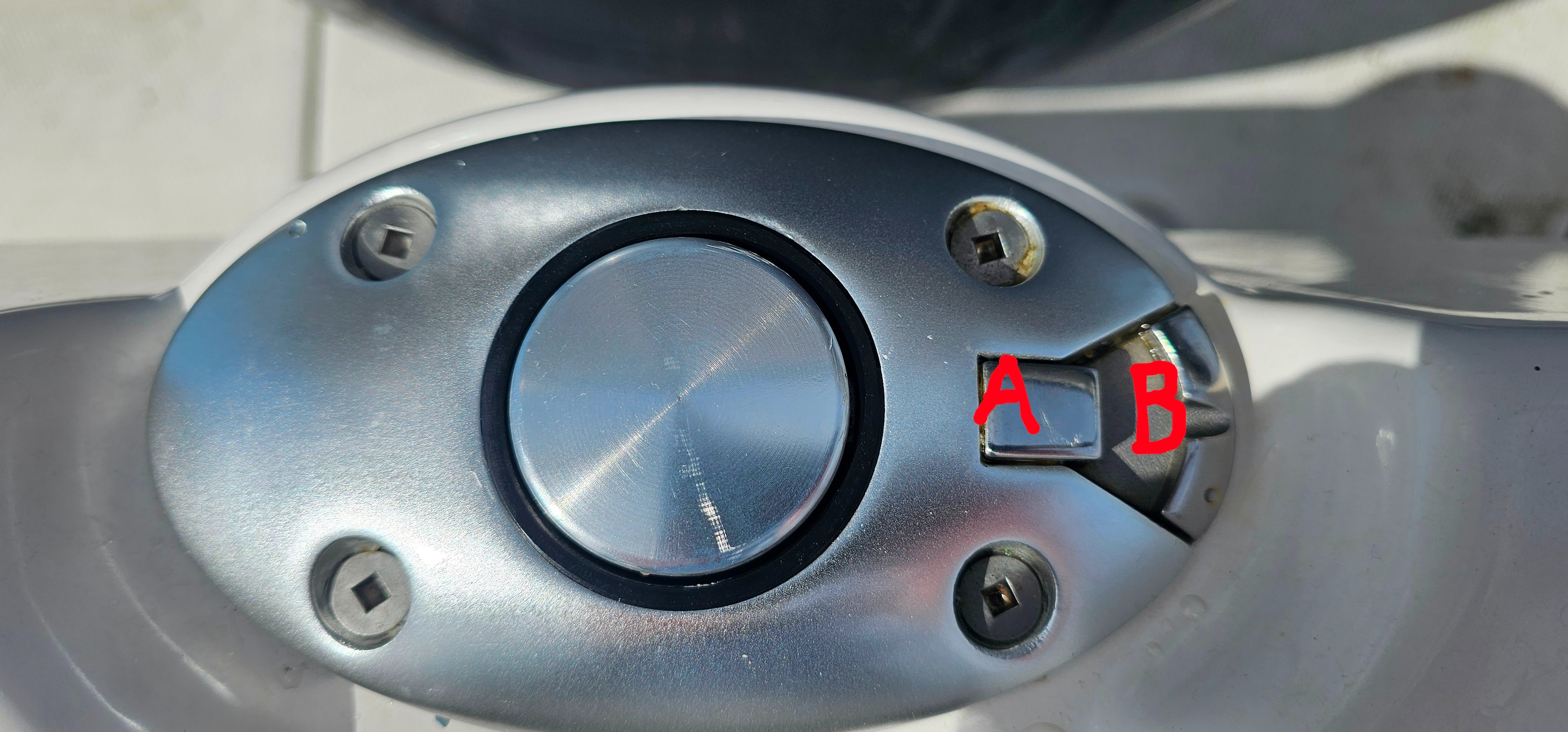

I need help understanding which way to slide the release button. I've attached a marked-up picture. What piece (A or B) slides and in what direction (starboard or port) ?

The whole part that you are looking at moves outwards away from the pole. I use the palm of one hand to wiggle the pole up and downwards while pushing out on the lock. I also use silicone lube spray on mine and it helps but it is still difficult. When I first got our boat it was stuck and I had to use a small piece of hardwood and a hammer to get the lock to move.

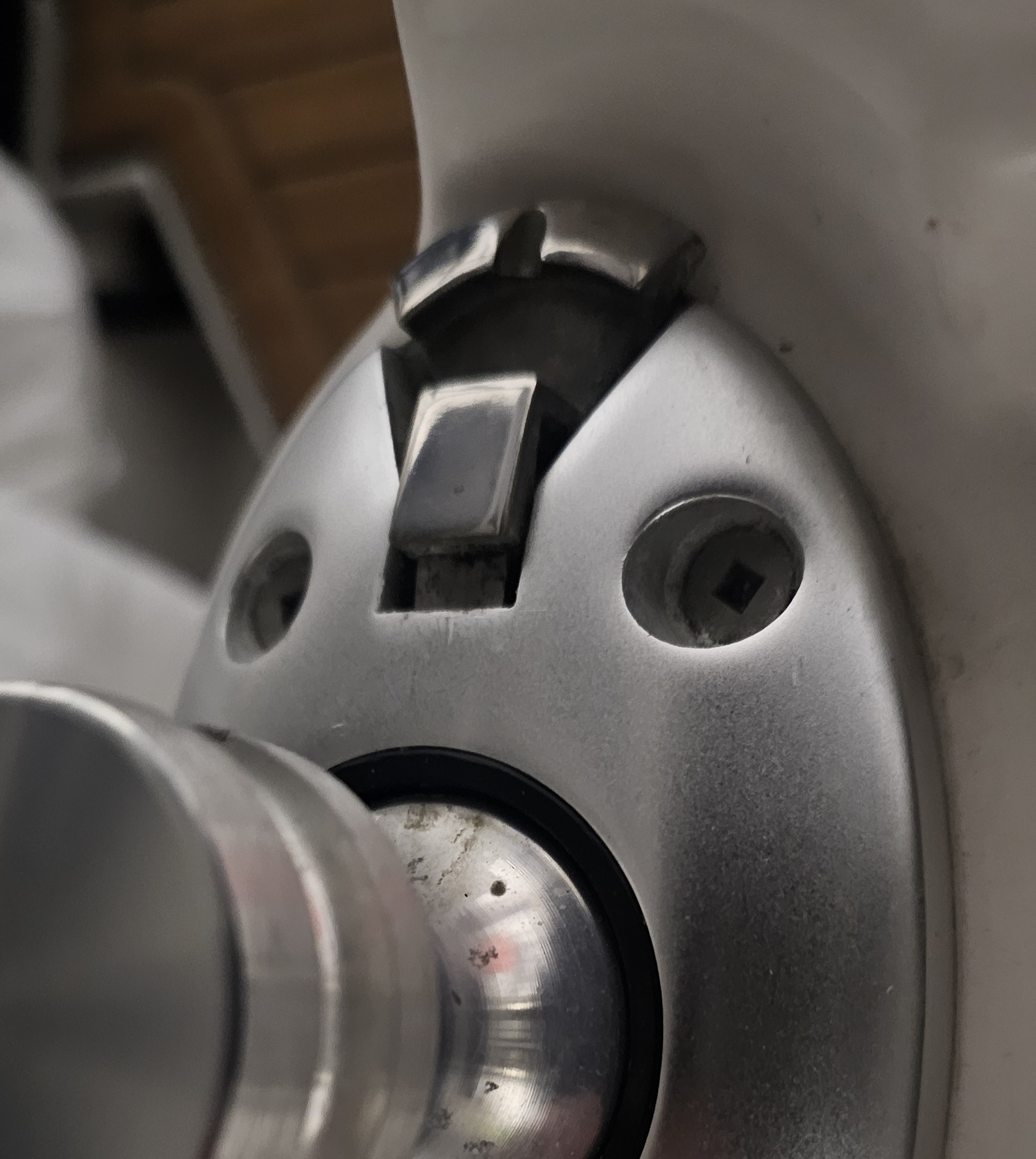

Here is a pic of the lock in the out position.
