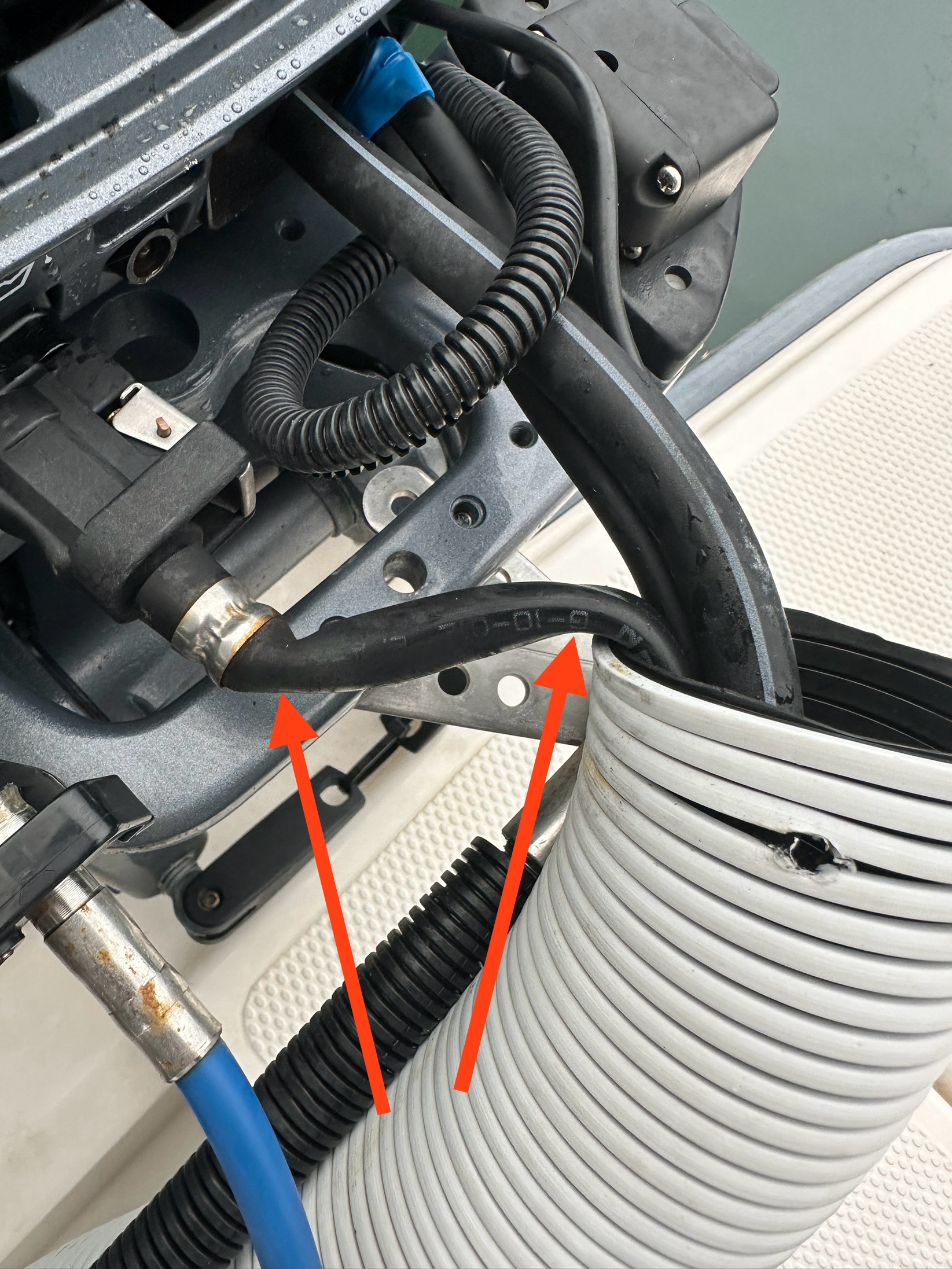

I was out fishing and my 9.9 hp Yamaha outboard wouldn’t start. I eventually traced the problem to a kinked fuel line coming out of the wire loom. Hope this helps some of you out there.

yes its a sharp bend - ended up taking the white tube and everything in it and come straight out of the back. it sits on the swim platform but it doesn't get in the way and now the shifter cable, etc has a much straighter shot.
