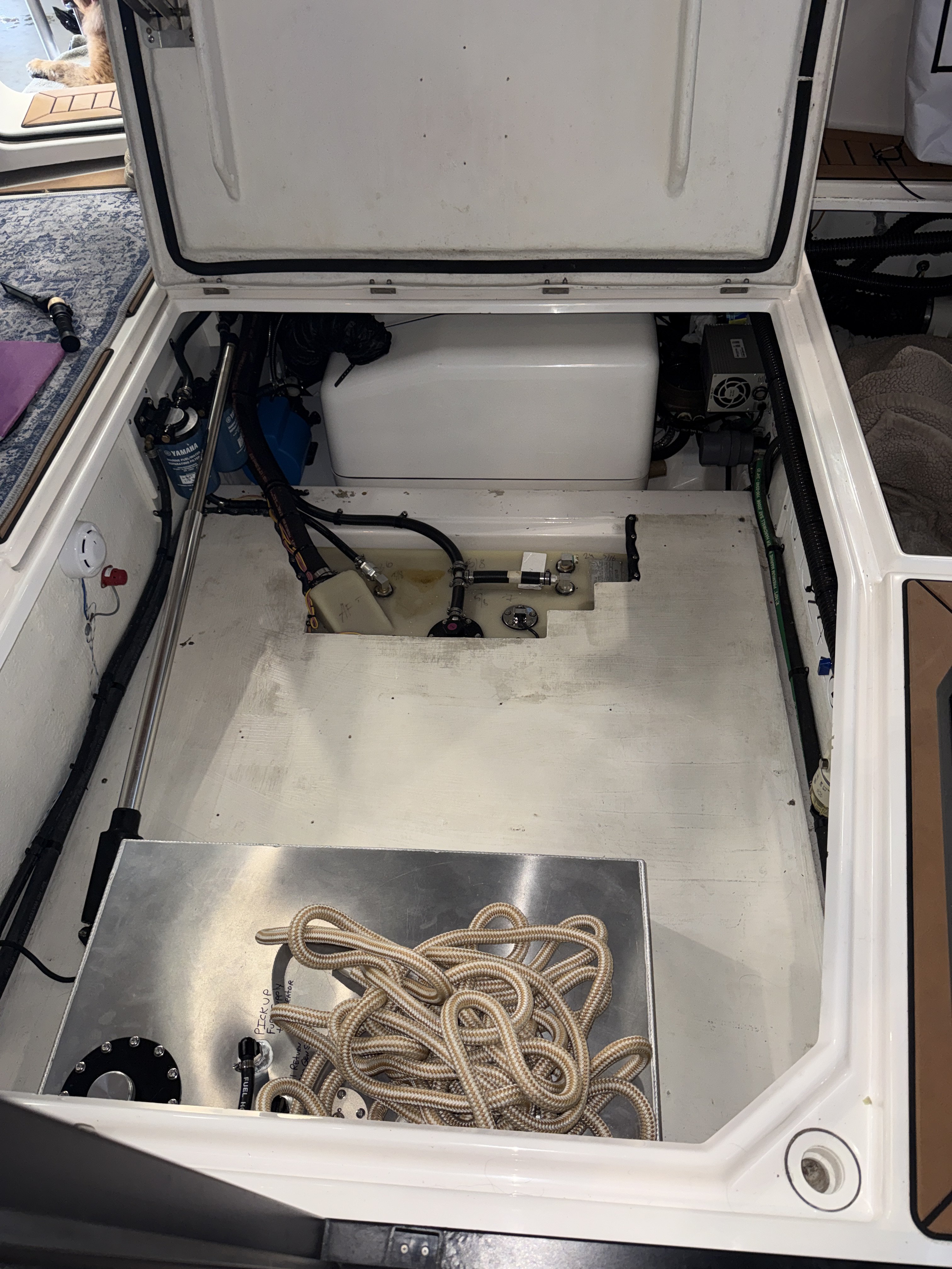

We removed by taking off all external generator components we could until the remains would fit through the opening available. When just the gas motor and generator piece was left she came right out…Probably could have removed the generator portion from crankshaft, but that would have required fabricating a tool. Mostly the exhaust and manifold were the size limiters, other stuff was removed to lessen the weight. The “experts” wanted to cut fiberglass structural panels. It was pretty easy job, just took our time. We did remove the “floor/hatch” cover at the hinges to facilitate easier access. Secured the exhaust for future replacement with a “diesel” gen set.

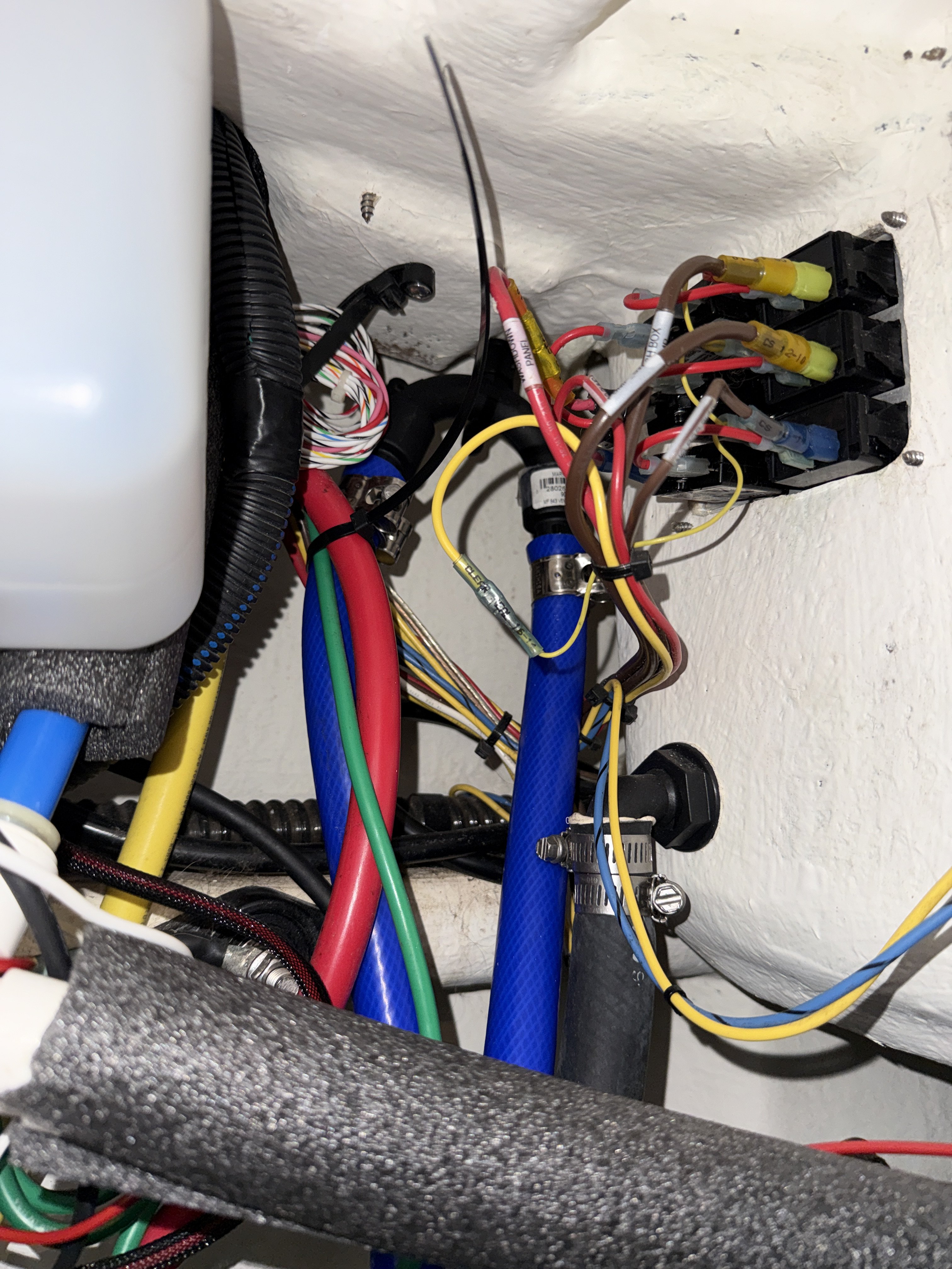

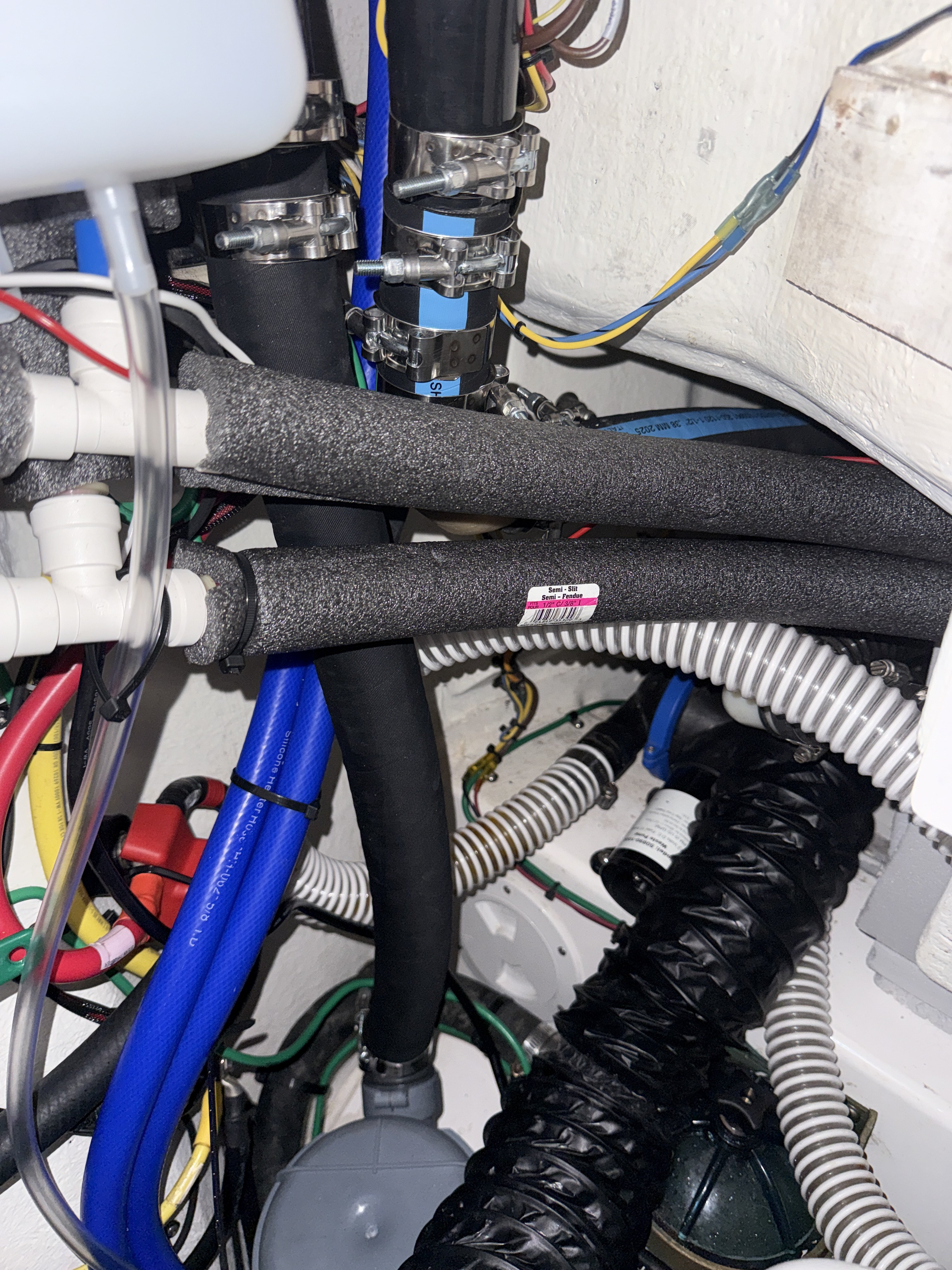

New NEXGEN 3.5 diesel generator install was completed September 2025. We have been busy using the boat and forgot to post our post install update. Thought I would share a few photos in case others might be interested in details. Not to difficult, just required patience and many, many pieces and parts for the connections, exhaust, etc. We calculated the weight savings at about 200# compared to the original Westerbeke 5.0.....Although the NexGen is only 3.5, it runs both air conditioners on our C302 just fine.....We have not overloaded it yet, but we also turn one air off to run hot water heater or grill just to be cautious....One really interesting thing on the NexGen is that it only has 1qt oil capacity....It does come with a remote drain hose set up and we improved on that a bit with valves and dedicated drain container to make oil changes super easy...We added a couple of valves and connections so that after running generator in salt water we can hookup fresh water garden hose for flushing while the generator runs during cooldown period.....Both Cooling Water (Blue Hoses) and Exhaust "Anti Siphon" loops fit well on aft port area at transom and provided just enough height for positive slope of exhaust to existing gen exhaust through hull......The fuel tank is installed at forward end of "engine bay" storage area under cockpit floor. We also have a diesel heater installed although we have the LE version of C302, so both genset and heater were set up to draw off the newly installed 19 gallon diesel tank. The diesel heater is 12V and we have a full enclosure in the cockpit area. The diesel heater was installed in the cabinet where we removed the cockpit fridge. The compartment was sealed to protect from any gasoline fume intrusion. We also installed fume detector sensor system in the bilge area as an extra measure. The NexGen clamshell cover is very easy to remove for super easy maintenance....We elected to orientate with the service points aft and hose, electrical inlets aft....Easy access to both front and back of genet with covers removed. We also replaced the wood mounting floor with a Starboard replacement. Fuel burn is about .2 gallons per hour with both air cons running. (of course they do cycle). As part of the install we installed new bilge exhaust blowers and man o man are they quiet in comparison to the originals (we have to put our hand over air outlet to make suer they are running with cockpit floor closed...We set it up so one is intake and the other is exhaust to keep good fresh air flow that is used for combustion and cooling inside the enclosure...Any questions are welcomed. We are very pleased with set up and our cruising has been very comfortable...We are back to "GenSet ON, Engines ON, Lines OFF, let the cruise begin!!!

Thank you for the kind words. We actually enjoyed the process! Learned lot’s too! We ran new control harness/control head and removed old one (fit in same opening) Diesel has a “pre-heat” function, but basically works the same with start/stop, monitoring, etc.
