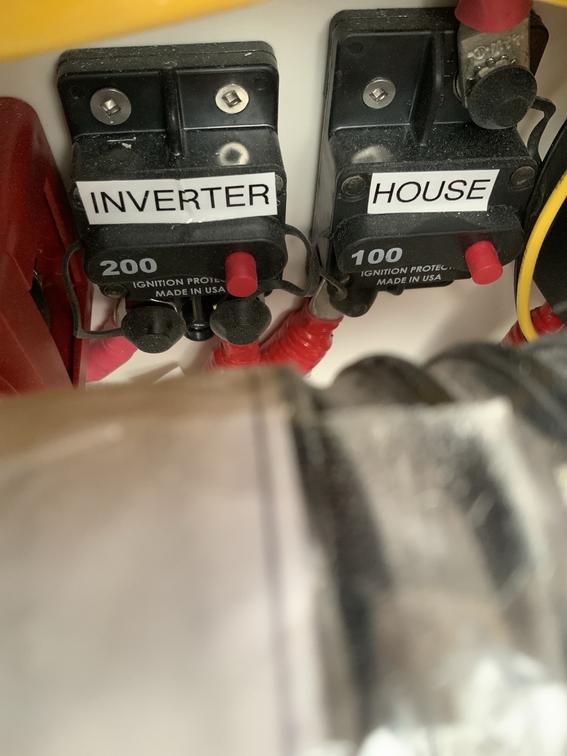

Yes, I believe that I reset this. However, if there’s a specific sequence required, I’m not sure that I did it correctly.

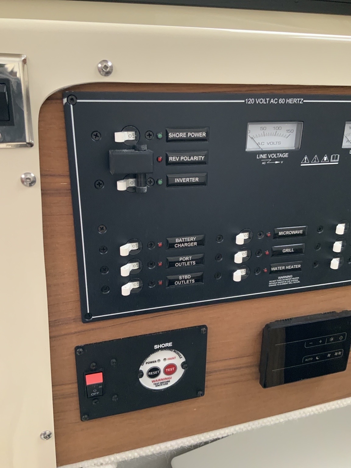

Just a follow up question, does the shore power bypass the inverter when it is connected.
You reset the ELCI in the bottom left corner? Looks like the breaker is in the off position in the photo. Need that reset and on, and then the main AC breaker on at the top.
From the looks of your panel that's not a pass through inverter, that manual slide lockout is to prevent you from connecting shore power and the inverter at the same time. It's either/or.
Got it, I’ll give that a shot. Thanks for the help.

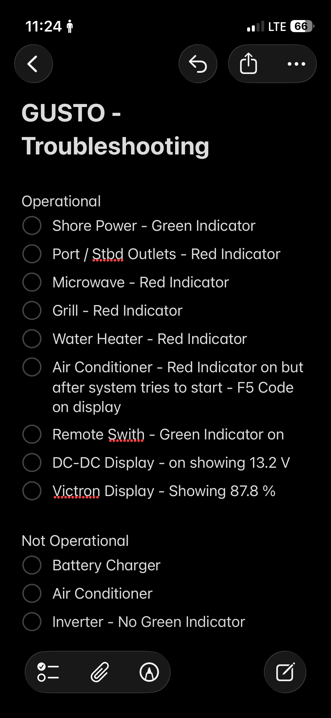

Any ideas about the inverter reset.
If I press the left button with the question mark. Power comes on then it cycles through a couple of readings then the dial turns off again
This is the Current Status
