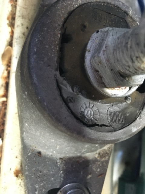

I went through 2 sets but not to the extent that they collapsed. Any photos you could share? Did it affect the condition of your cutlass bearing?

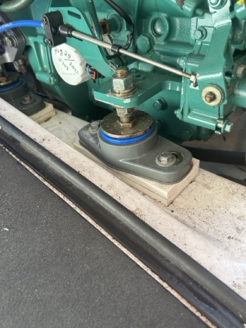

On mine multiple cracks in the rubber were visible in all 4 mounts. Not sure when it started to crack on the original set but I replaced them with the same type at around 1700 hrs. Paid more attention to the second set and cracks started to appear after only 300hrs so I replaced them with another brand. (Polyflex) After another 400hrs I noticed that the front mounts were starting to compress or deform. Contacted Polyflex and they informed me that they had made a modification to the replaceable insert and sent me a free set. I have put around 800hr on this set and they still look good. I've checked alignment a couple of times in that timeframe and have not had to make any adjustments. (3600hrs on engine now)
Note: As I've mentioned in other posts, I use the boat strictly for fishing and mainly trolling, so low RPM's which as you know has higher vibration levels and harder on the mounts. Also with the polyflex I noticed smoother engine at idle in neutral compared to the VP type of mounts but a slightly higher vibration through the hull when in gear at low RPM's. If I had to replace them anytime soon I would see if they had any with softer Shore Hardness.
