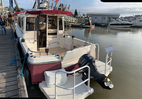

Very interesting picture. Someone added a plate. And drop fins on the existing factory trim tabs. That should make up more than enough for the extra weight of motor, fuel tank and added support for the motor. If it’s like my R31 with that big of trim tabs and drop fins you could easily over trim at fast cruise speed. I can not run fast cruise with the tabs al the way down. It hurts fuel economy and speed . Also make sure you raise the tabs all the way at slow speeds as it also negatively affects speed and economy.
I like your setup KlaassyC
this is a 2015 but I can't see that it could change much. Certainly takes up swim grid area and you have to have the kicker down before you can flip the stern seat to the rear ward facing position.

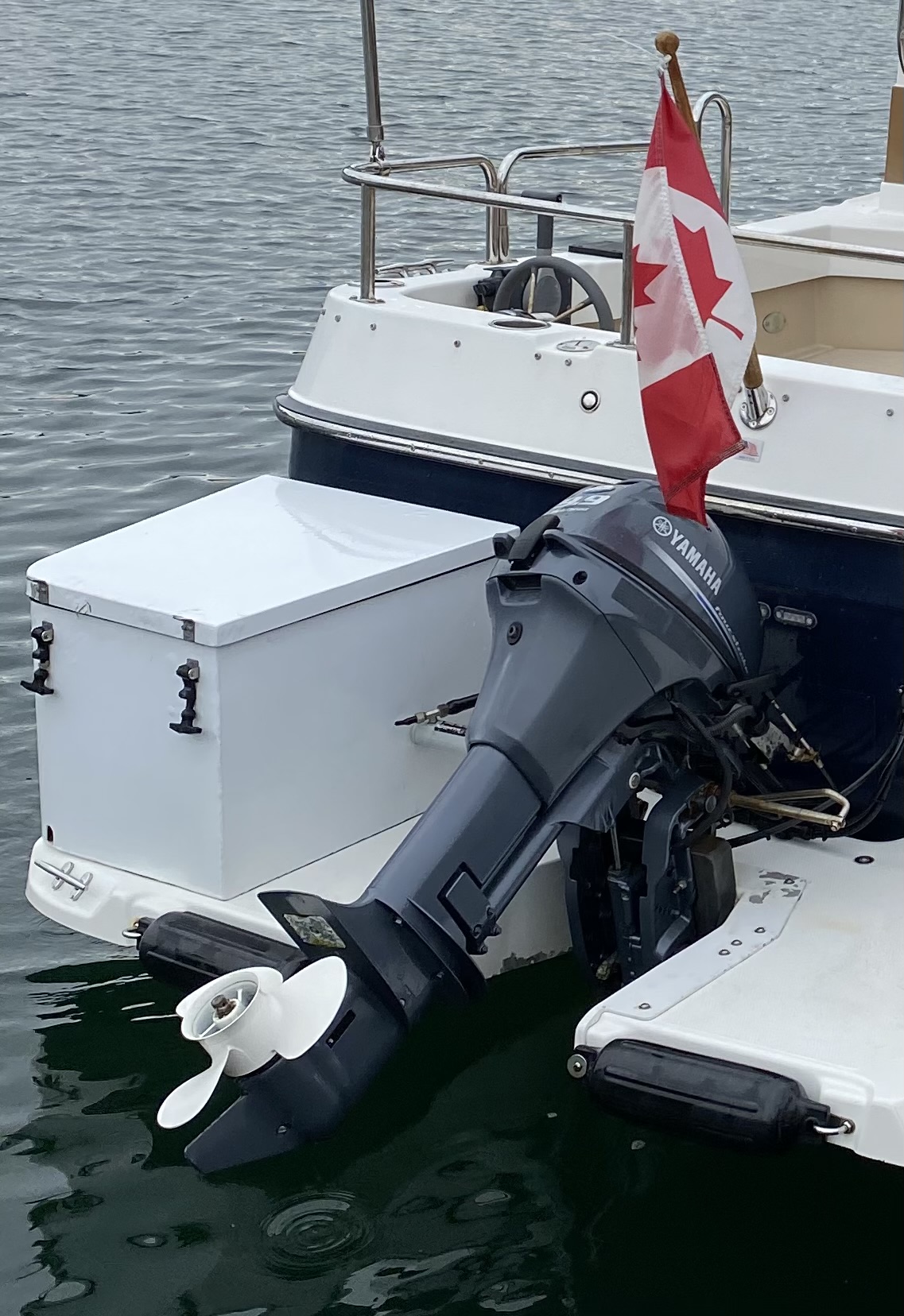

This was from my 2013 R25SC. 25 Litre Fuel tank was in the metal box on the swim grid.
