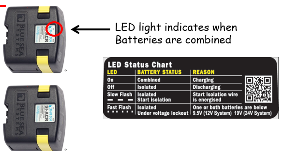

Been doing some re-wiring, solar, LiFePO house battery, you get the idea.
The ACRs have a wire connected to them that appear intended to drive an LED as confirmation that the ACR is engaged.
On my R25SC, (2011 model year) that wire is in a bundle that goes 'somewhere' and following it looks difficult. Where does it go? If the boat has an indicator LED for the ACR, I'd love to know about it.
Thanks
