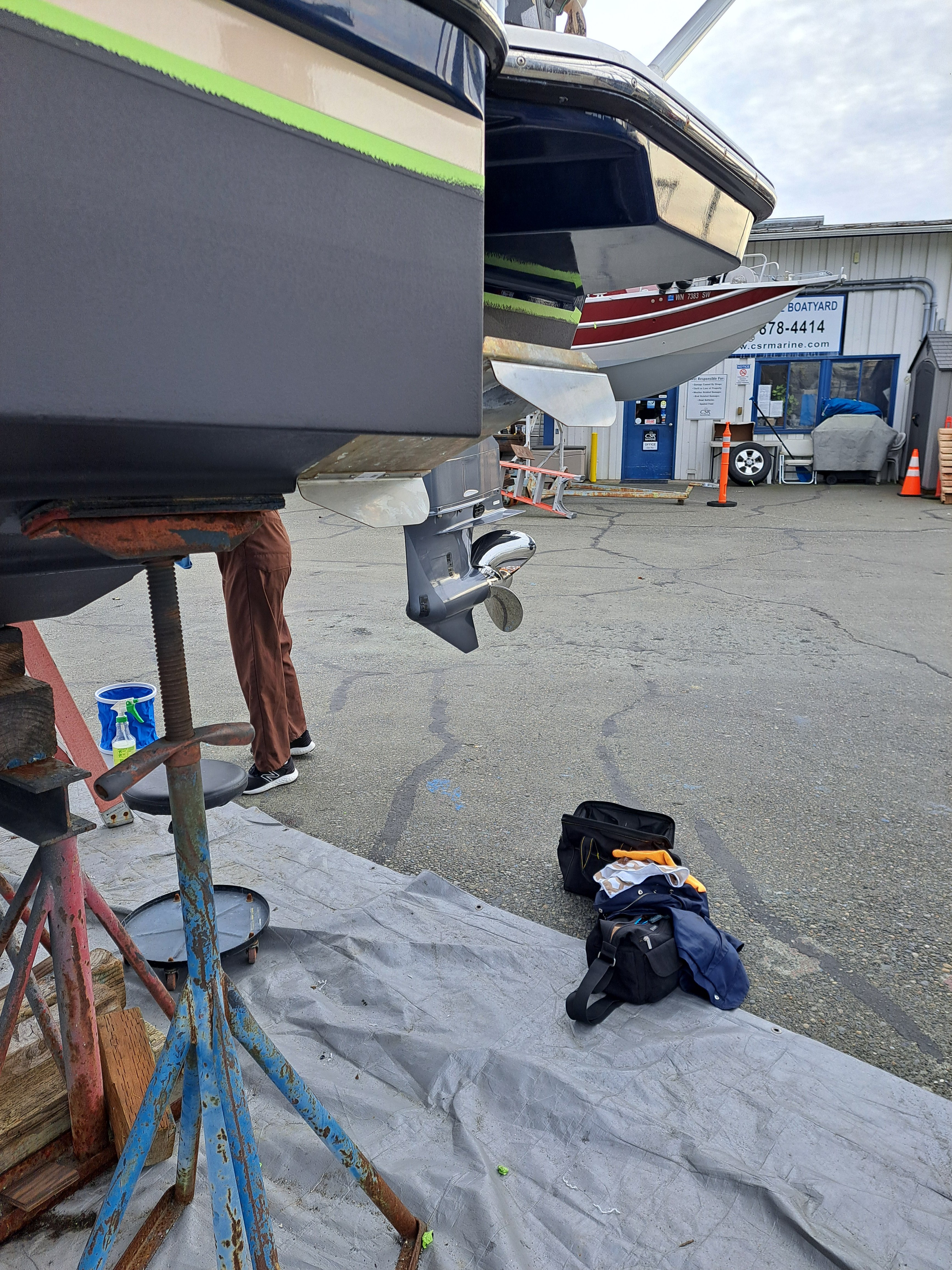

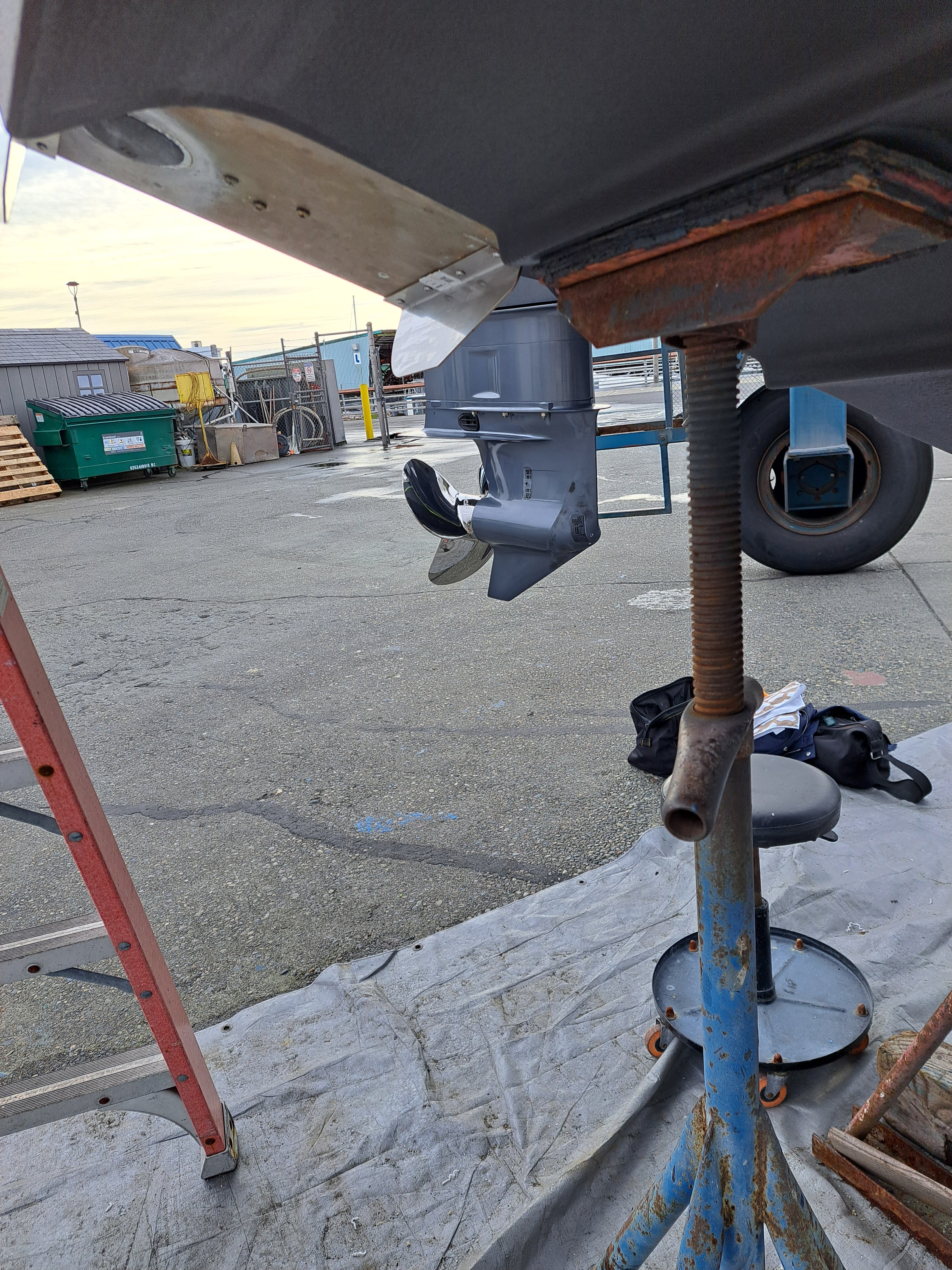

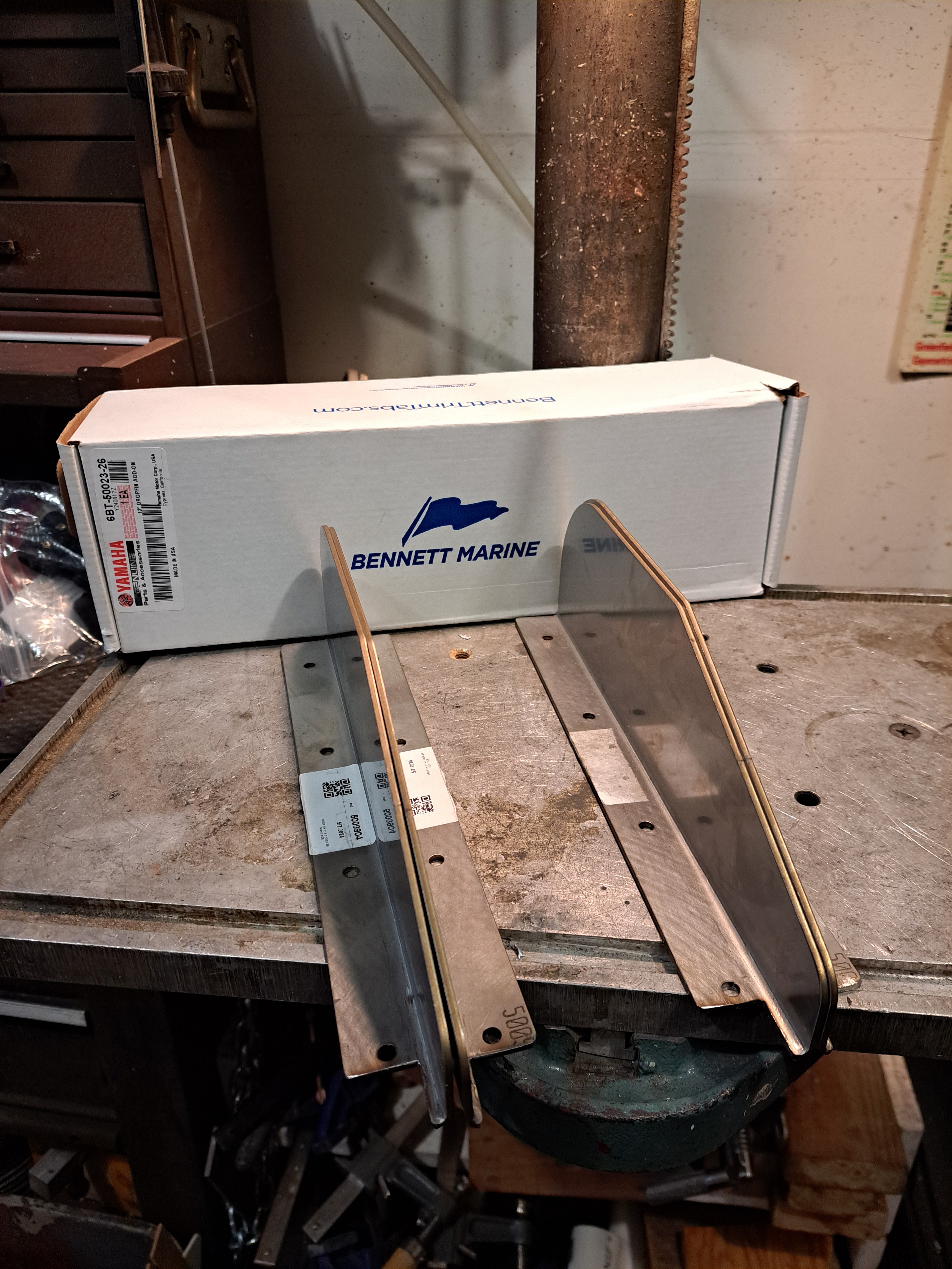

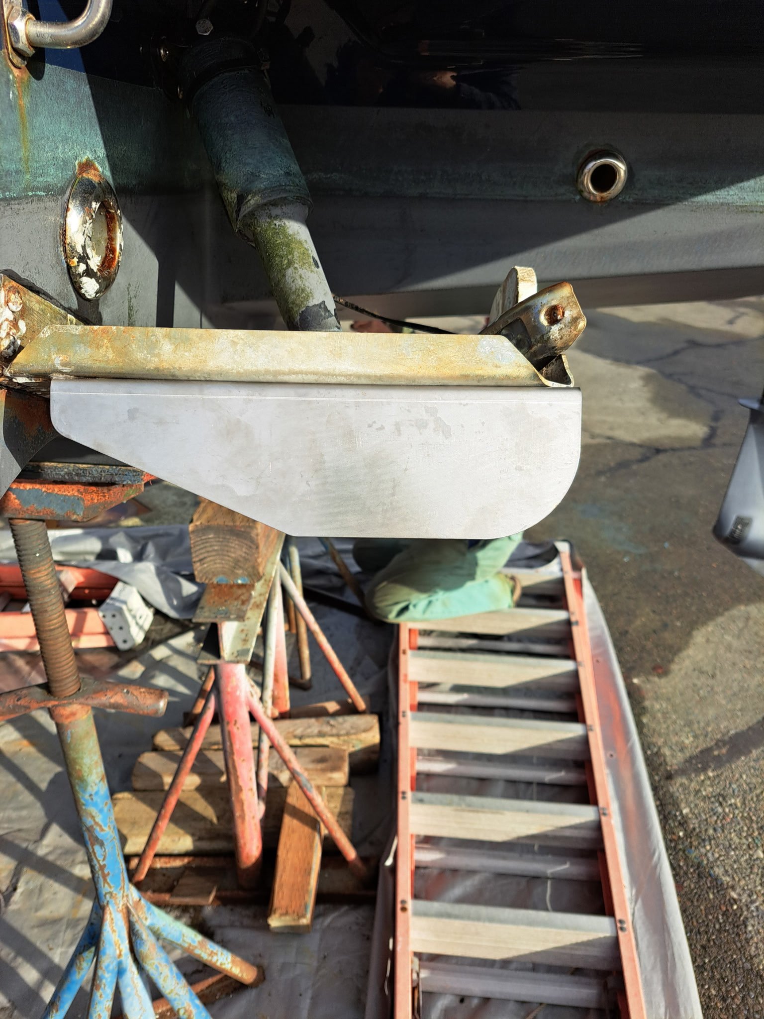

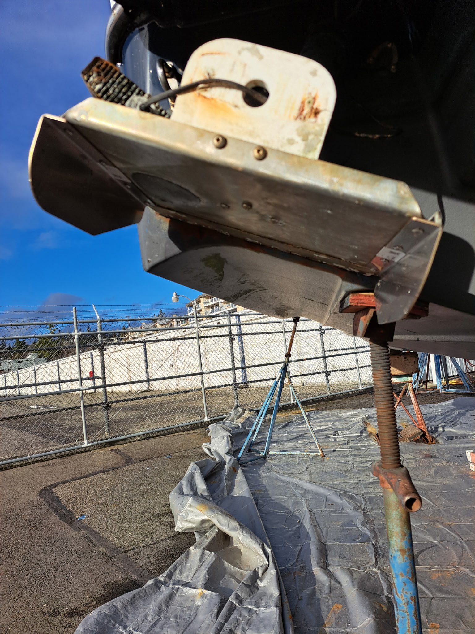

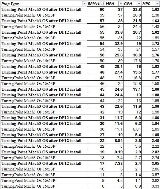

Feb 28 picked up our boat from CSR Marine South (in Des Moines WA) . New CuKote bottom paint and installed Bennett DF12 drop fins to our 2022 R27OB. With our current TP Mach3 OS 15.6x13P 3-blade prop, running north to Elliot Bay Marina, in a minor headwind, incoming tide and in the fog I got some "rough numbers" captured.
I can say it runs flatter, I barley had to bump the helm starboard trim down to correct the typical list back to level running at 30mph.
I didn't touch it after that. Backing off the throttle slowly there was no noticeable stern squat till I got >4k/20mph. I didn't adjust trim to compensate, as I was busy watching the radar in the fog.
Overall, it would appear my GPH dropped slightly with MPG increased 2-3 tenths. The "attitude" of the boat is very stable, less perceived roll, and the slow speed wander is all but gone. I understand the R23, R25 and R27 are planning hulls, but the before and after performance difference is noticeable, and to us worth the $50 in parts plus labor to install.
