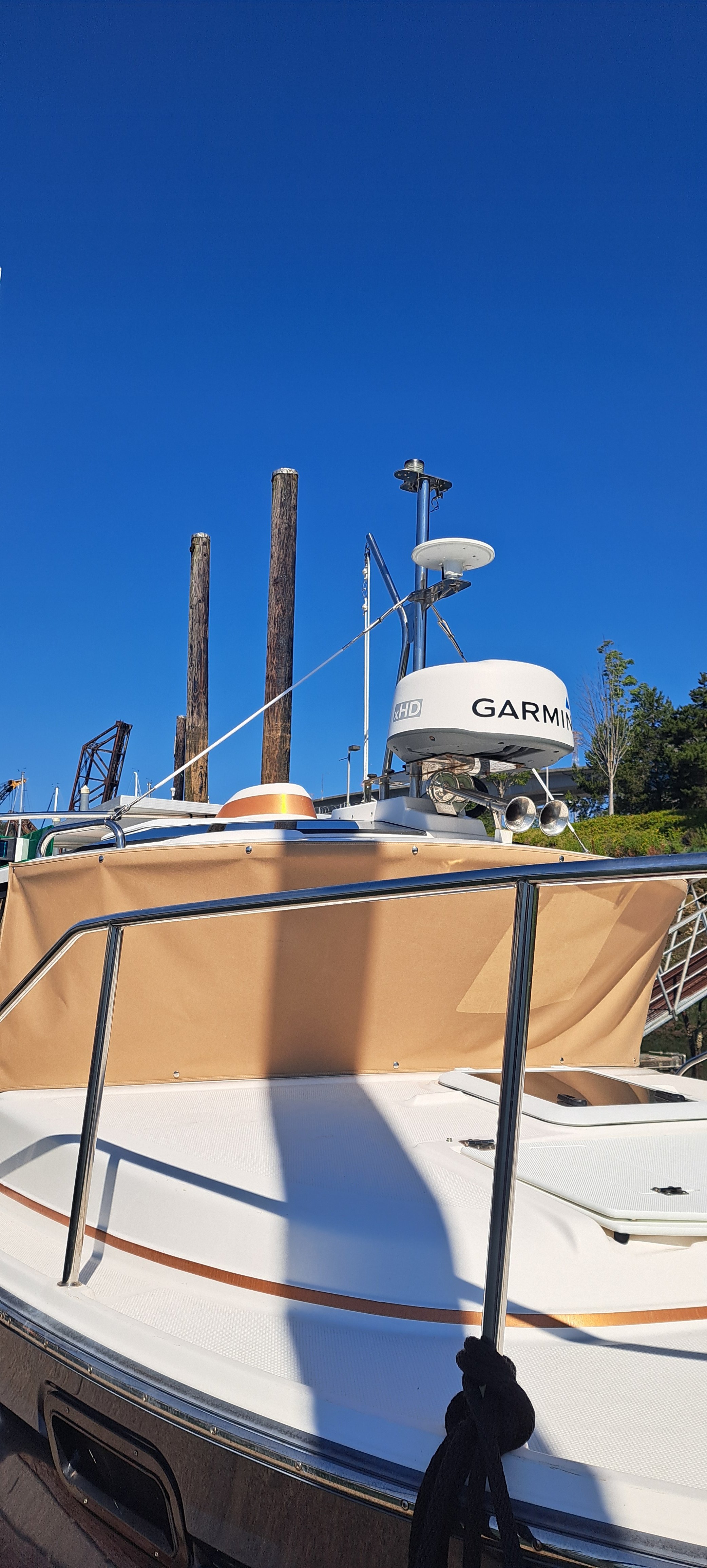

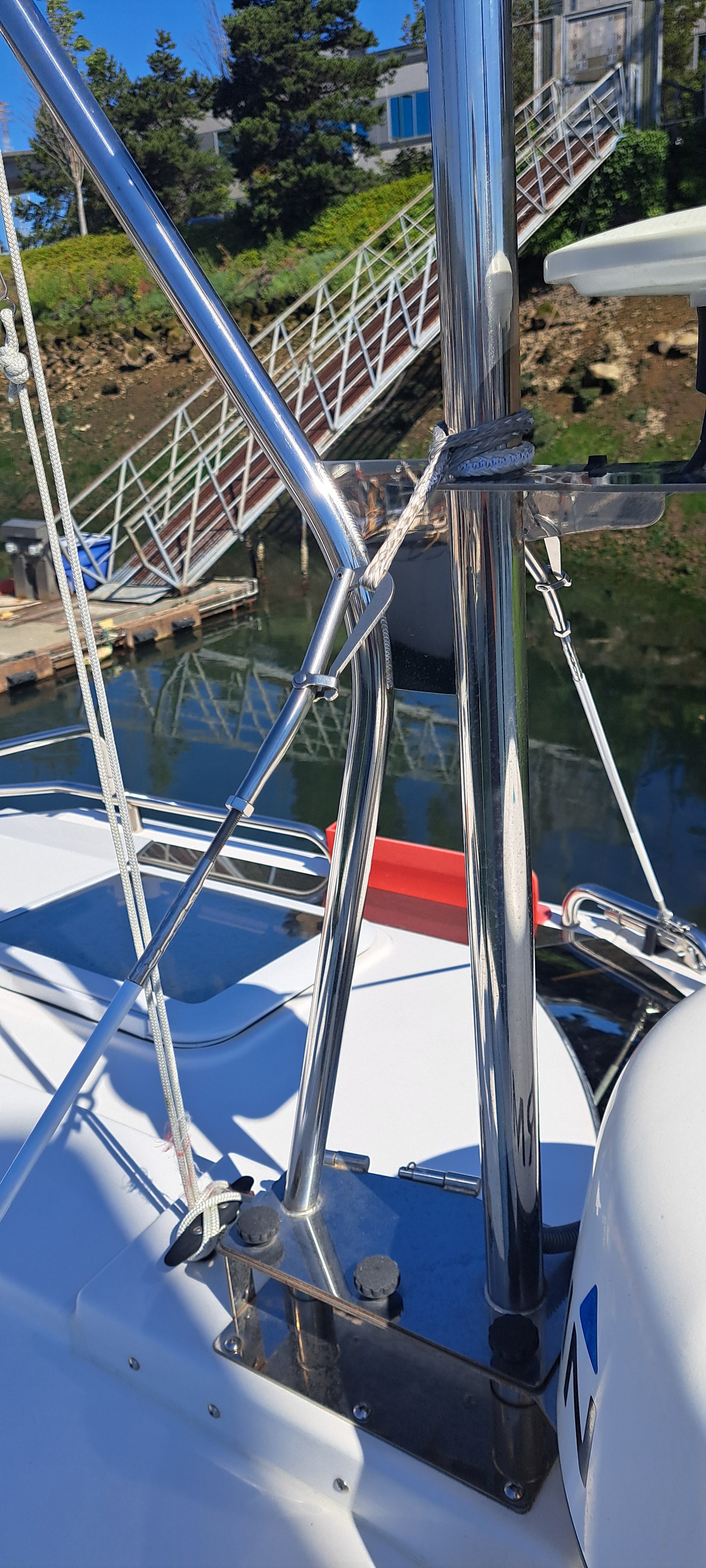

Following in the Footsteps of Martin Nethkin/ChannelSurfing, we added "shroud Lines" to our 2022 R27OB mast.
We did not have a problem with mast cracking, but a few owners have, therefore we see this a proactive addition.

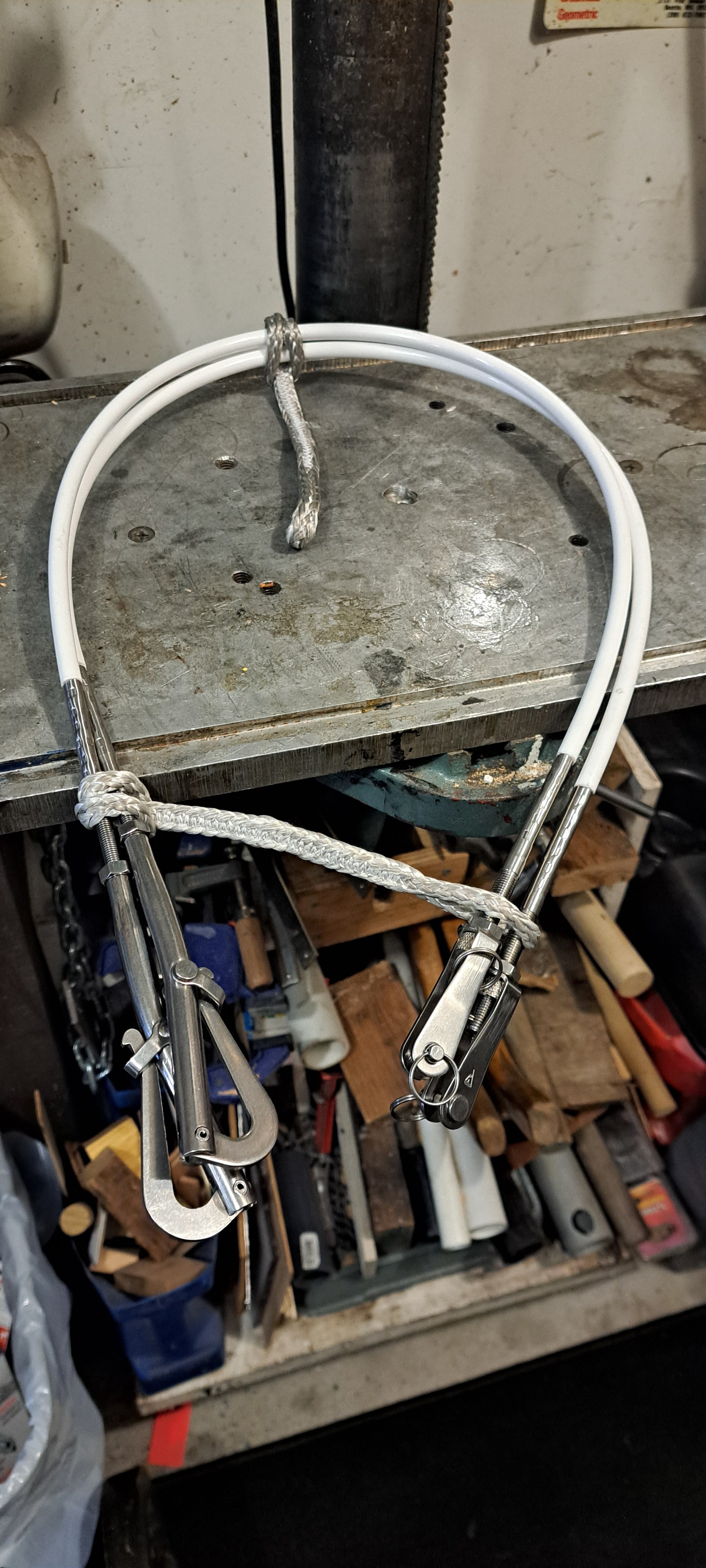

We used coated 3/16" Stainless Lifeline cable which is larger than needed, but this is a very common size with numerous fitting options.
A slimmer version would be to use 5/32 cable size, but the connector options become limited.
There is also "uncoated" versions" if that look is preferred.
The parts list is as follows:

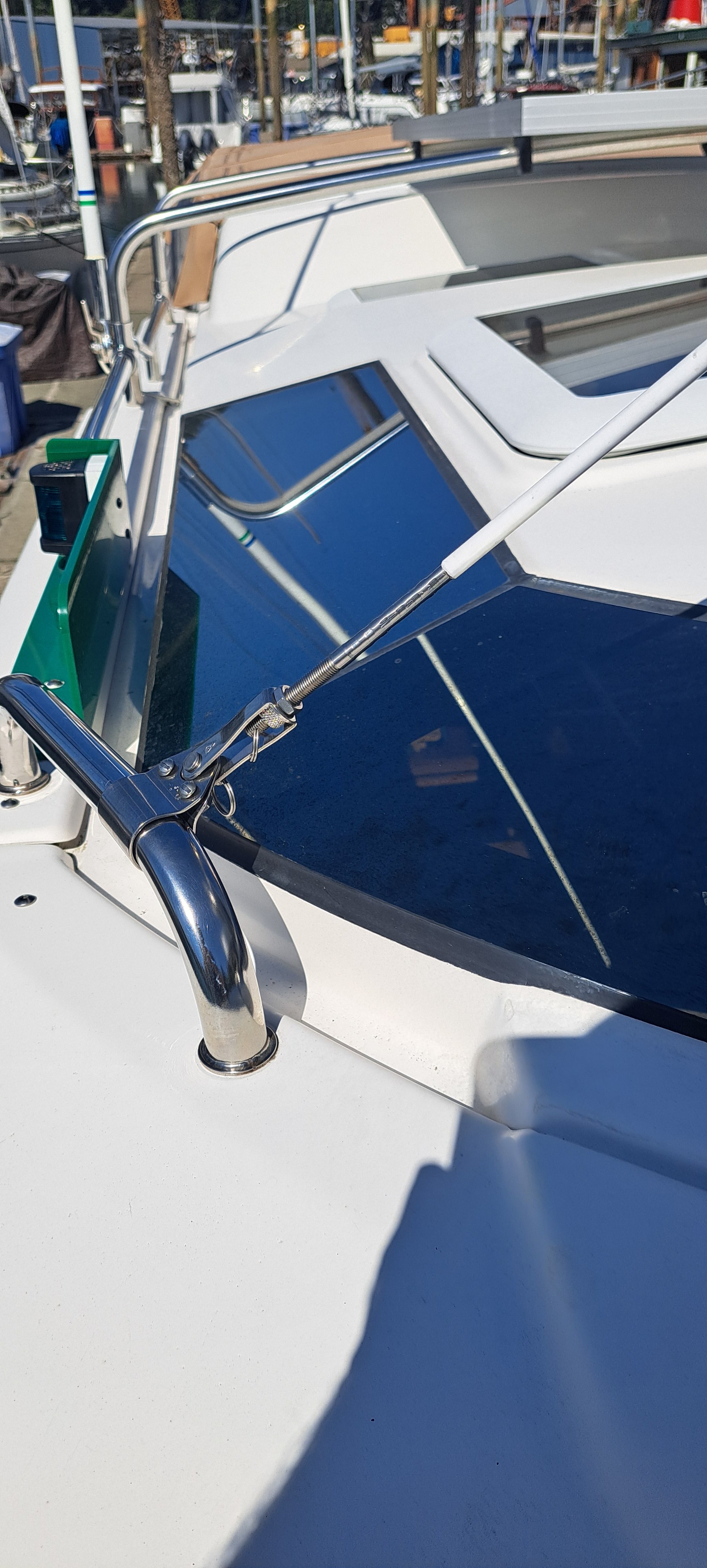

C.Sherman Johnson 27-403 3/16" Tubular Pelican Hook (x2)
C.Sherman Johnson 27-406 3/16" Shore Adjuster (x2)
C.Sherman Johnson 29-501 Pulpit Anchor (1" Rail) (x2)
Davis LineGrabber #2460/pair

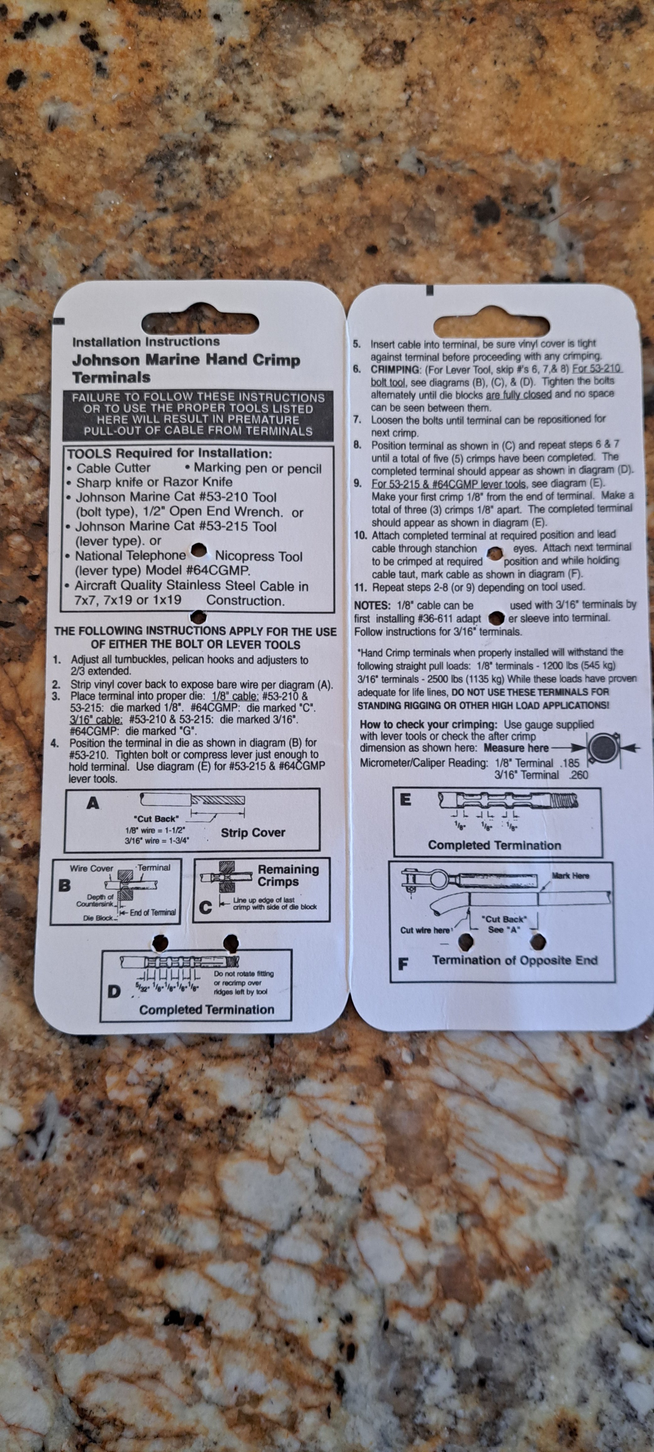

Following the instructions for removing the coating in order to get required length for the crimped tubing and performing a rough mockup at the boat, we ended up requiring 30.5" overall cable length, with 27" coated material. This was with over 50% of the threaded fittings exposed for future adjustment.
