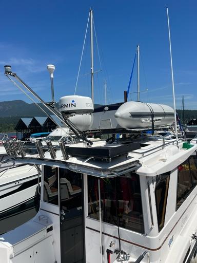

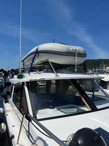

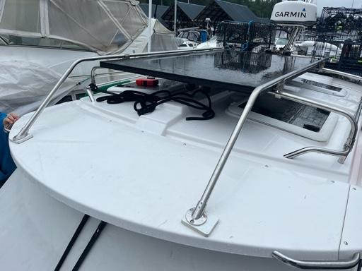

Here’s my solution for both. There’s a 355W panel in the Center, then a pair of 1” rails that run fore-aft to protect the panel and guide the dinghy on. When we get to an anchorage we drop the dinghy in the water and have full solar.
This is great information, and thank you for the pictures. This gives me a great place to start!
