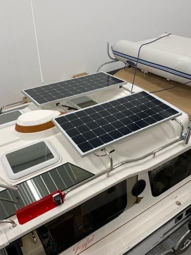

Can’t answer your questions exactly, but we just upgraded our 2021 RT27OB (Northwest edition). I used a pair of 24v panels in series (200 watts each) and a Victron smart solar charge control unit (100v 50 amp). Same wiring. Love the Victron app on my iPhone. As an aside, I also installed a smart battery monitor so I can keep track of all things battery related using the same app. Happy with the result. Now all we need is some Sun up here in rainy Bellingham WA.

The two CMPP22200S (200 watt) solar panels I installed on my boat have a VoC of 38.9 (Nominal of 33 volts at 6 amps). They would work, however, they'd have to be installed in parallel, not in series. (Have to keep the open circuit voltage below 50 volts.
The DMT1250 DC to DC charger will accept input from either the engine or solar, but not both at the same time. If the engine is running, the engine is charging the batteries. If the engine is turned off, then solar is charging the batteries.

Connecting the panels in series provides higher voltage which reduces the amperages for the same amount of power. Amps create heat in the wire due to resistance, heat is lost power. Also, if you wanted higher wattage panels, which means more amps, the RT27-OB came with #10awg wire that's rated for about 30amps.

For the purposes of our boats I don't think it really matters much. The biggest problem with solar on a boat is space to mount them. Series or parallel is really a decision made by the owner based on the solar controller they have (have to stay within the open circuit voltage limitations and amperage limitations of the wire). You can do parallel with a set of Y cables, or you can do in series... either way, you shouldn't need to run new solar wires throughout the boat.
I wired my 2x200 watt panels in series, the panels I purchased are shade resistant, and I get all our electrical needs met with solar. The RT27-OB doesn't really have a shading problem up top where the panels are mounted.
https://www.letsgochannelsurfing.com/solar-power?pgid=kxcvakr2-256ffab8-5fa0-4439-acb0-b857554b0c4f
