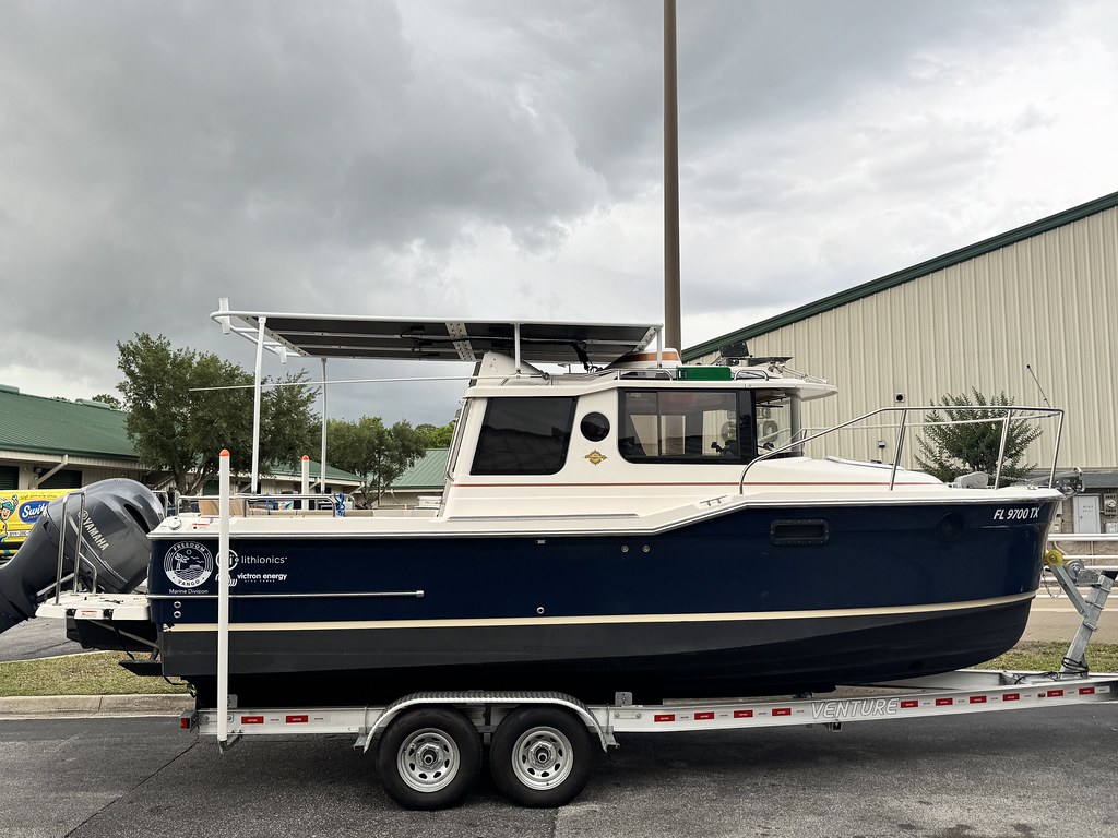

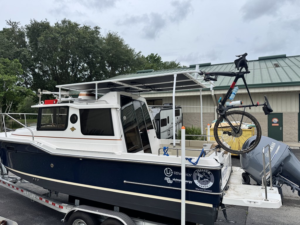

When I upgraded to a lifepo battery and a bigger solar system I went with a single bank solar charger. In order to make this work I had to rewire some of the circuits. I removed everything, I mean everything, from the engine battery except the engine itself. I brought the parasitic load down to zero while the engine switch is off. I also replaced the shore power charger with two units. One lifepo charger and a tiny trickle charger for the engine battery.
What inverter did you use?
We find using a victron multiplus and using the trickle charge function works great for engine battery, then we just need one separate for the thruster
I am using the lifepo to power the bow thruster. It is rated at 200 amps continuous and 400 amps for 5 seconds. That seams more than enough to handle the startup current. I also run the windless off the lifepo. The only downfall is I can't run everything at once.
I used the victron solar charger and victron DC to DC charger from the engine, the LiTime waterproof 10 amp charger for the house, and the NOCO 2 amp for the engine.
The system seems to be working great. With 500 watts of solar I generally don't even bother hooking up shore power. We only do it when we want to run an electric heater.

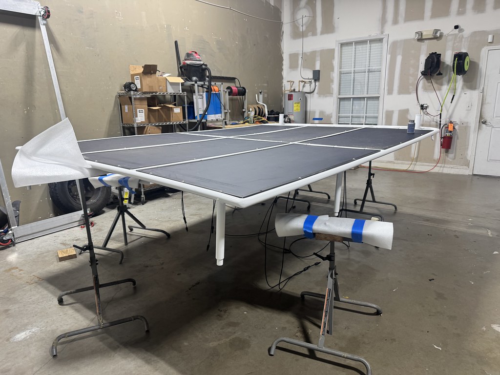

we manufacture it 🙂

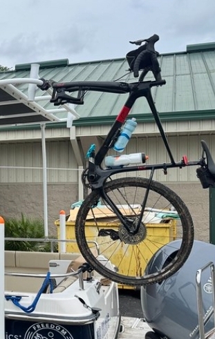

Can you point me to the hardware you are using for mounting the bike?
Sure
It's our diy clamps we have manufactured for us (we use the same size tube that we use for the sprinter roof racks we make)
That is used to mount a freedom coast designs adjustable mount
I use this mount in a few vans and the boat and swap it around. Can mount to L track or has holes for mounting
And on the bottom side used some generic Amazon 1" clamps bolted to a 6" piece of l track to hold the wheel. I bungee the bike down using the l track as tie down point
