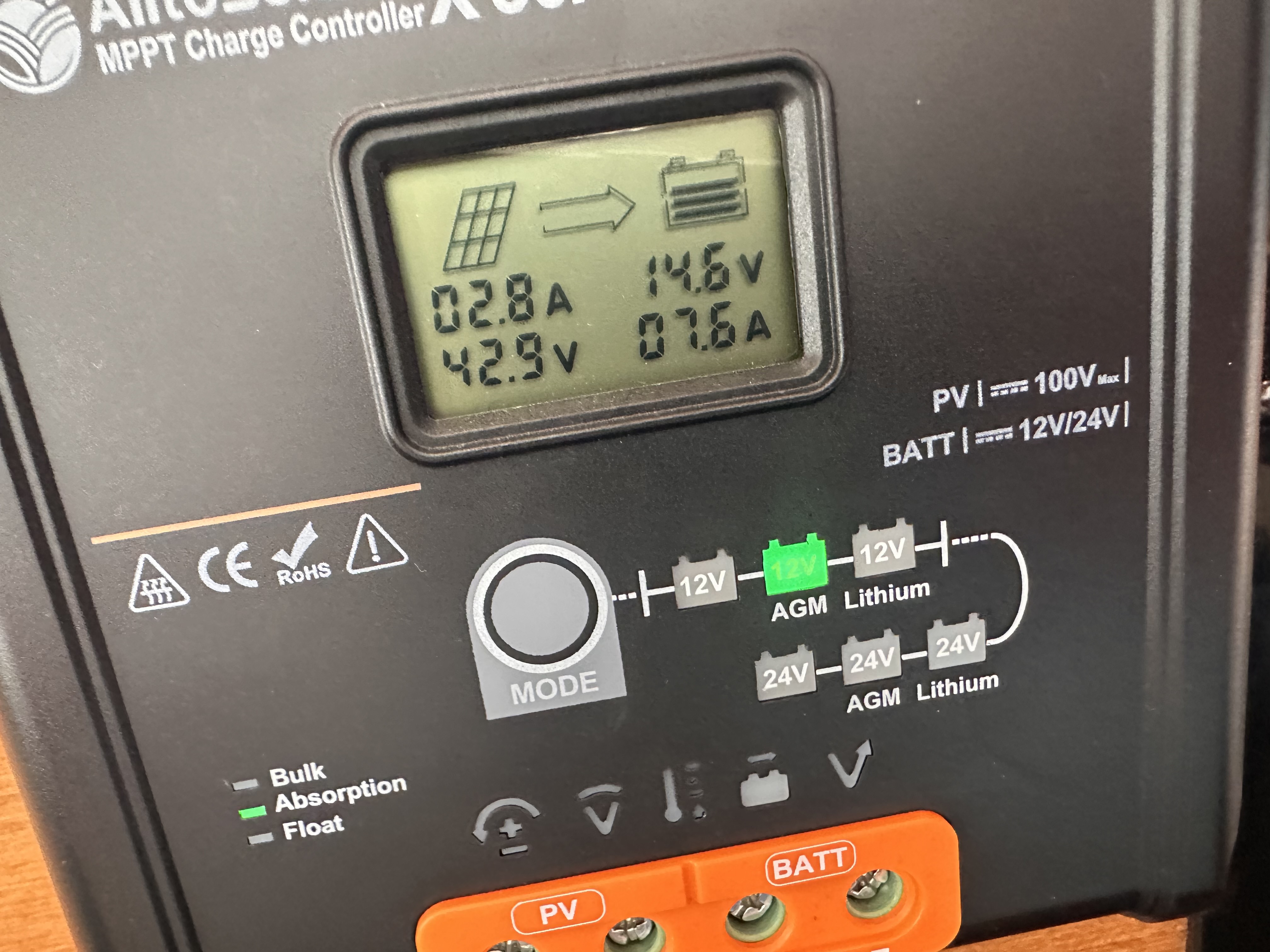

I’m pretty new to my 2019 R-27 outboard and I think the pair of house Interstate AGM 31-AGM7 batteries probably need replacing.
I did some simple practical tests: I turned off shore power and all devices except the galley fridge and whatever background systems run like the Propane sensor and switch (but in standby off position), inverter switch lamp, CO monitor, etc.
Then the solar controller readout for my twin 195watt solar panels (390watts total) showed
charging the house and engine and thruster batteries to between 13.99 and 14.5 volts. The solar readout photo attached.
The Victron Battery sensor readout was 13.99-14.3volts—at 2pm on a partly sunny day—all seemed good.
