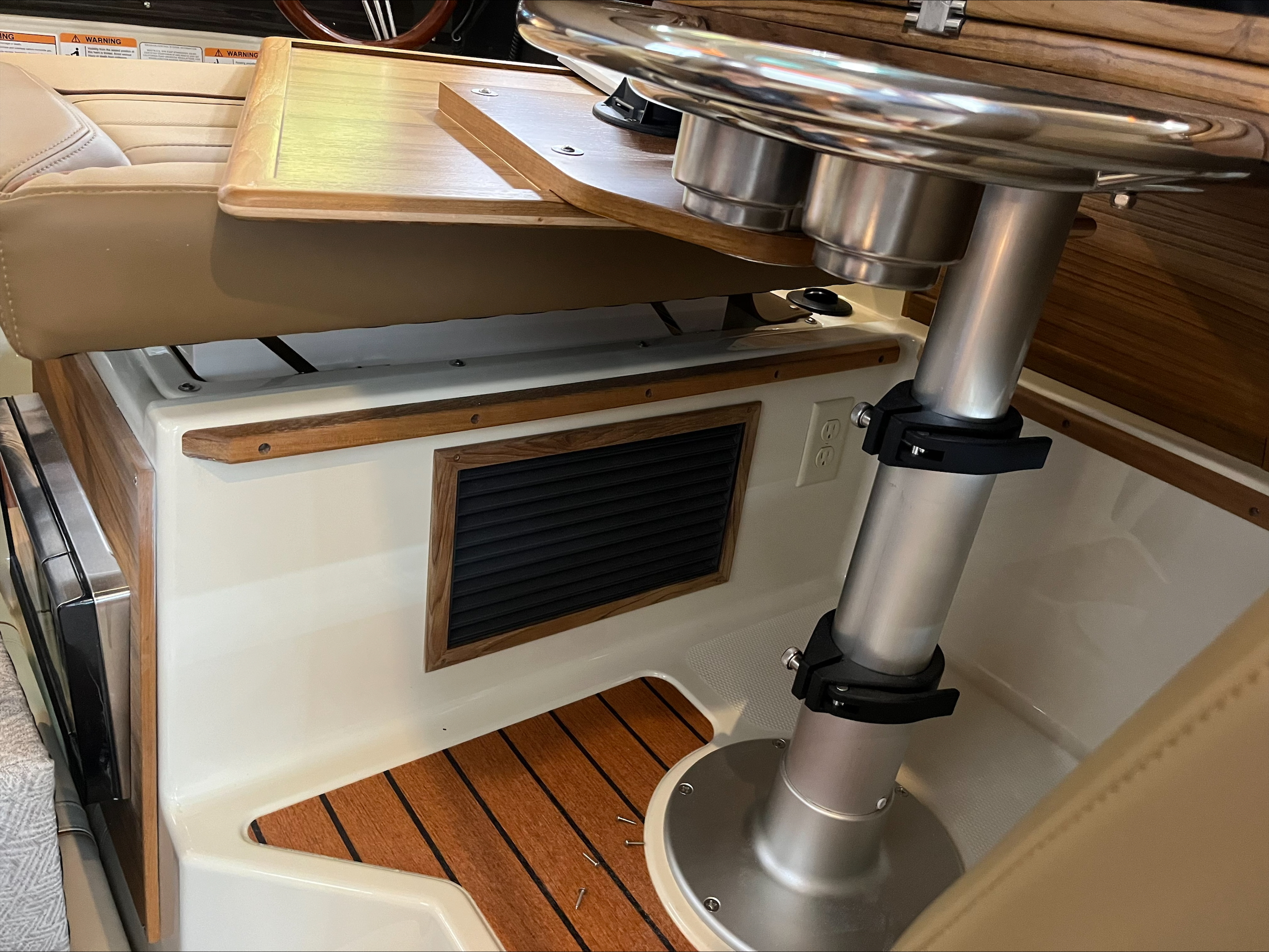

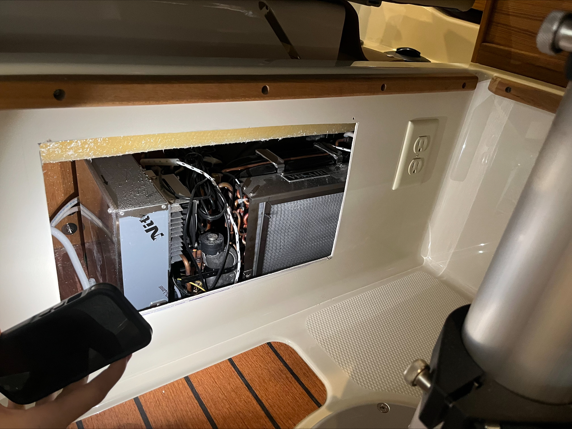

I did get cover off bottom of A/C unit and poured a good amount of water into drip pan and it seamed to drain just fine. I must have froze up the condenser causing it to drip. I also called my salesperson to ask about how to access the A/C unit. He wasn't sure so he looked at the 2025 he has on display and sent me pics of what has changed. Obviously this has been a problem so they changed the vent/access location. I have to remove the microwave on mine.
processed-2FDD70D9-0BFC-497F-A102-A35452B65E6E.jpegprocessed-C2FB51D9-1860-4744-BF07-8F1E8BE84420.jpeg
View attachment 25866View attachment 25867
Wow, I'm just noticing but it looks like FM has either switched to Velair or are offering it as an option.
