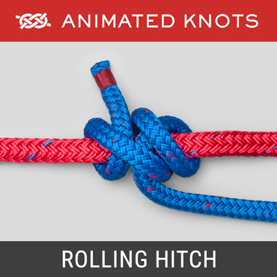

If you dont want to buy something just use a rolling hitch using a line from the cleat. worked well for me.

Do that when I need to go past 135' of chain and into the rope rode and plan to sleep on the anchor, but usually in less than 40' of water am all chain.

Thought I'd share my process:
1. Drop and set anchor.
2. take a bow line and tie a rolling hitch between windlass and covered part of anchor roller onto the anchor line - i.e. on the deck.
3. have the bitter end of the bowline free.
4. let the anchor line out until the rolling hitch travels over the bow roller taking the bow line with it.
5. grab the slack bit of the bowline and pull the whole bowline through the anchor roller so you are able to run it to a cleat on the bow. Tie off the bowline on the main forward cleats.
6. Run out the anchor line until it goes slack and the bowline now takes the strain.
7. make sure you have enough line out so when the boat swings the load is on the bowline and not the anchor line.
Would it be possible to take a pic the next time you set up? Thank you in advance.

Anchoring with a true bridal can make a difference. A true bridal is stretchy which helps with the anchor holding, and the V shape reduces the tendency for your boat to swing back and forth. You can also spread the V wider to help with the swing by choosing where it goes over the bow. I started with a rolling hitch and dock line but we anchor or tie to a ball 40+ time per summer and I found the bridal much more enjoyable.
