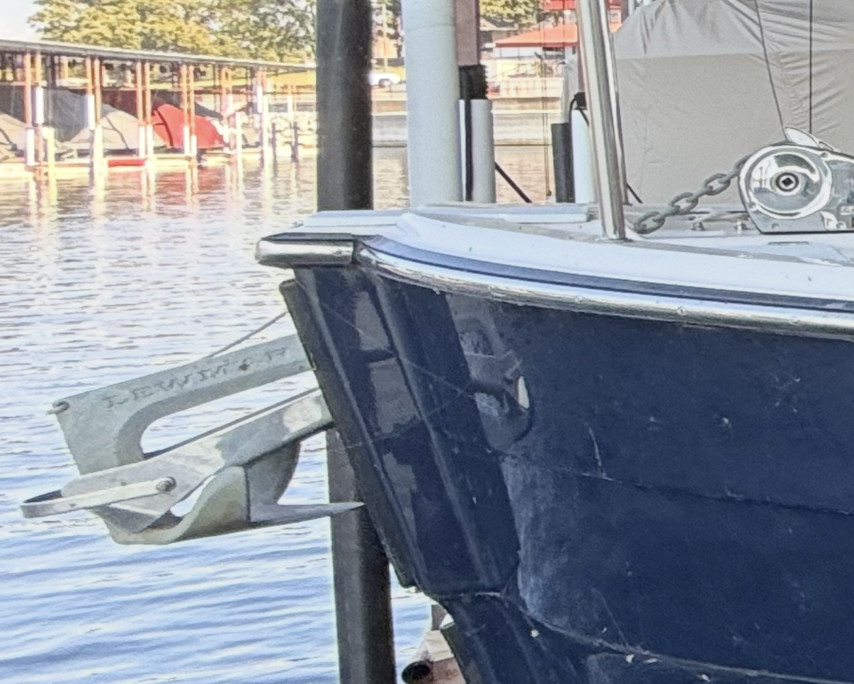

We have a 2021 Ranger Tug R31 Sedan and got caught in a storm on the 4th of July. Several boats and a buoy got all tangled up and we had to cut our anchor rope to get free from danger. Two divers later, we cannot find the anchor and chain. Does anyone know what we need? What Lewmar anchor and what size and length of chain??

Chain is 5/16 G4 and rode is 5/8 inch . Factory is 50 feet of chain and 200 rode.
I would upgrade to a Rocna 15 for the anchor and a Mantus swivel. You will need a Mantus anchor guard if you upgrade the anchor.

The anchor guard is not necessary on the R-31

My anchor setup is exactly as "Mike and Sarah" described. Always holds well. And pulls up well.

On our r31 the tip of the new Rocna would contact the black plastic on the bow without the anchor guard.
