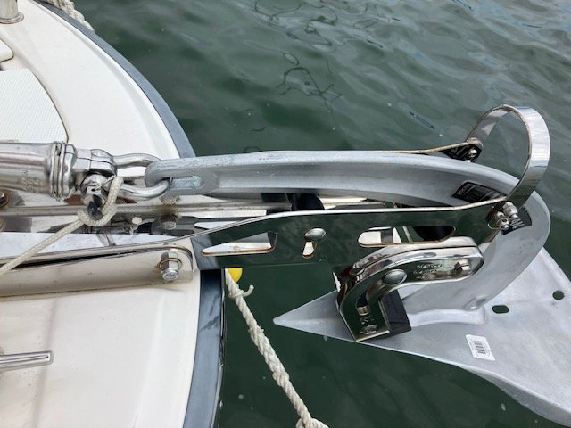

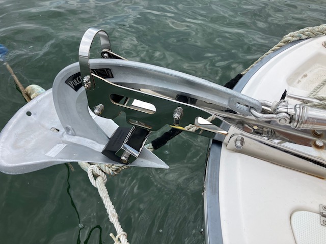

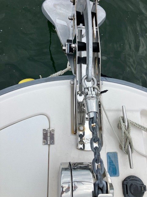

We finally got to the boat to photo our anchor setup. We replaced the stock Lewmar anchor and roller with a Vulcan 12 and a Mantus BR-1 roller. We also added the Mantus anchor guard and swivel. I have attached pictures below:

We added the BR-1 because the tip of the anchor was at risk of contacting the SS bow plate even with the anchor guard in place.
BTW, the BR-1 fit within the base of the Lewmar roller and matched the rear bolt holes, two holes were needed to be drilled in sides of the BR-1to bolt the forward end to base of the stock Lewmar roller.
While BR-1 roller does not have pivoting feature, the anchor deploys and retrieves smoothly.
I like that the original base of the Lewmar roller didn’t have to be removed in order to use the Mantus roller. If I understand correctly the forward end of the Mantus roller is held by two bolts that insert from the sides into holes that were drilled into the new roller while using the same holes that were the pivot point on the Lewmar. The factory Lewmar roller had a third bolt towards the forward end attaching it to the deck. Did the BR-1 simply go over that bolt with attachment to the sides or did that third bolt get used as part of the mount? Was that third bolt removed and the hole filled? Were the two forward mounting holes on the BR-1 used at all? Many thanks for all the great information and advice! The new Mantus roller just arrived and is a thing of beauty.
I will attempt to answer your questions, but feel free to direct message me or reach out to serendipity.r27ob@gmail.com. I’d be more than happy to chat at greater length.
1. The factory 3rd bolt at the bow was not used. It was left to hold the Lewmar base in place. It was also glassed over under the deck and removal would have been a pain.
2, I removed the two aft bolts on the factory base and replaced them with 2 longer bolts that went through the rear bolt holes on the BR-1. I was able to use the factory holes as they lined up with those on the BR-1.
3. The 2 forward holes on the BR-1 were not used. However, I drilled two holes in the side of the BR-1 to line up with what I’ll call the pivot holes on the factory base. I then bolted the BR-1 to the factory base through those holes. BTW, drilling the two holes in the BR-1 was easier than anticipated.
