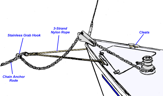

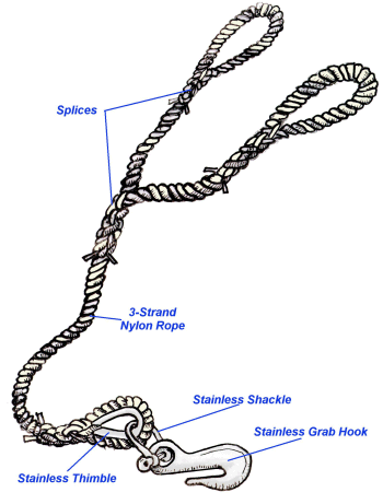

Here is a generic anchoring bridle:
Each of the limbs of the "Y" are sized to your boat. I left off the 'grab hook.' There are numerous hook-type devises out there if you want one. I prefer the silence of a tied rope connection rather than a metal-to-metal interface.
This pic isn't a Ranger Tug but you get the idea
In this pic simply delete the grab hook and extend the line a few feet and you have the "Y" configuration I'm talking about.
