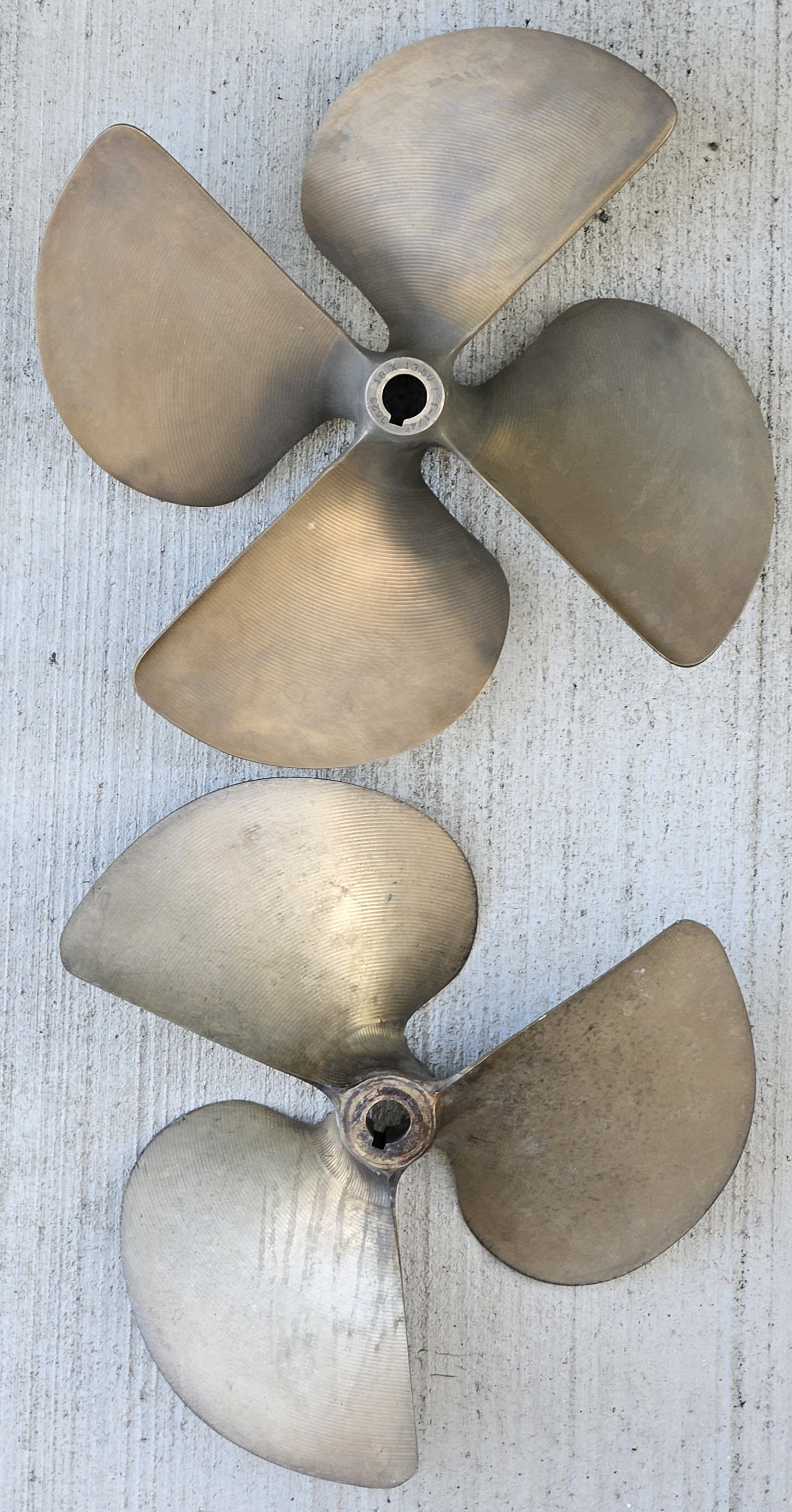

I'm contemplating re-powering our 2008/9 R25. As part of the exercise I've been studying prop alternatives for the engines I'm considering. And as part of that exercise I've been running the calculations vs historical performance of the boat. The boats have been around for a few years now so thought I'd ask what other real life experience people have gained.
So the question is simply per the thread title. Anyone running props other than the originally supplied 3-blade Acme? On the 25s the original wheels were either Acme 3-blade 17x15 or 17x14 both with 0.105 cup. Not sure but I believe the later R27s with the 200hp engine came with 3-blade 17x17 with 0.105 cup.
