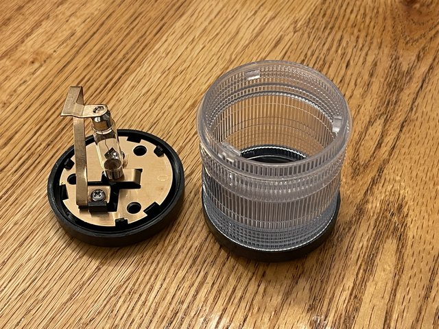

The anchor light on the mast of many Ranger Tugs is the Aqua Signal Series 25 Masthead 12V. Every once in a while, a question is posted about how to remove the lens assembly on this light to access the mounting hardware, the bulb inside or to check wiring integrity.
The Aqua Signal Series 25 has two pieces, the base and the lens. The base fastened in place on the mast with three screws and nuts. The lens assembly attaches to the base using a bayonet mount.
To remove the lens assembly from the base, push it down slightly and turn it counterclockwise slightly and then pull up. It takes very little rotation to release it, less than 1/16 of a turn.
The tabs on the bottom of the lens assembly are indexed to the base— one tab is larger than the other two. When reinstalling the lens assembly, position it so that the larger tab is aligned with the larger slot on the base, push down slightly and turn clockwise.
Here is the Aqua Signal Series 25 with lens assembly separated from the base. The lens assembly is shown upside down to make the tabs visible.
