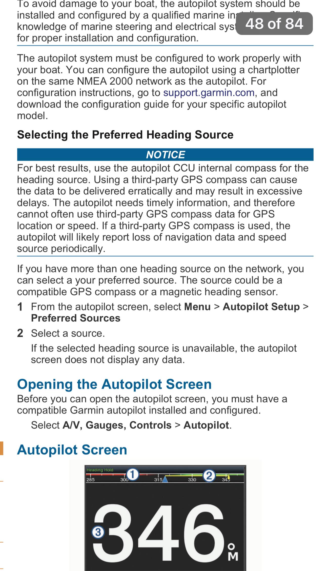

Here’s a warning from the owners manual. What is your heading source set to?

CruisingElvinRay has it right. The issue may well be with your heading source setting. Do the following:
1) From the autopilot screen, select Menu > Autopilot Setup > Preferred Sources
2) Select a source
You should have a choice for your Garmin GPS chart plotter. That would be the required source. Select that and try running the system again to see if you get the same issue. Hope this helps.
Cheers,
Ralf
I would disagree that the plotter needs to be the source. It should be the CCU compass, per the manual. The plotter may work, but why not use the CCU compass built in to the autopilot?
Our autopilot is set to the internal compass for the heading source as mentioned by CruisingElvinRay. It uses this for “Heading Hold.” When following a route it uses “gps steering.” This has worked well and I believe is the preferred method.
