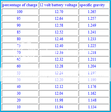

What you want to know is called "State of Charge." It ROUGHLY correlates with the battery's voltage. Normally, you don't want to discharge your batteries below 50% SOC...this equates to ROUGHLY 12.2V. Each episode of discharge to less than 12.2V (or less that 50% SOC) damages the batteries...exactly HOW MUCH damage is usually determined later when you find shortened battery lifespan. Of course, if the battery/s fail to recharge then they are 'toast' and need replacing.
This chart gives guidelines if you monitor voltage alone:
