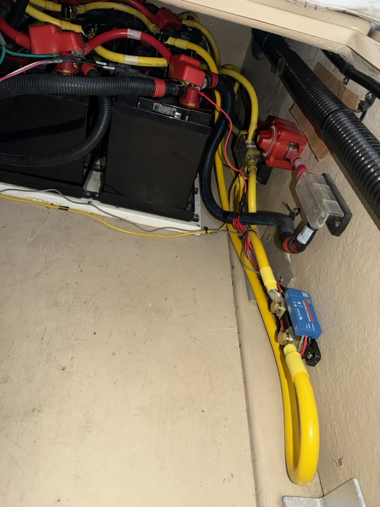

Bought a 2018 29 RTCB last year. Previous owner replaced some house batteries in 8/23. Now noticing that I now need to turn on 1 and 2 banks and use parallel switch to start engine. Voltage after start is 13-14 . Is there a procedure for load testing house bank and engine start battery? Will I run into problems with disconnecting the house terminals ? Also any tricks to access the engine starter battery without having to pull out the house bank of batteries. Thanks in advance!

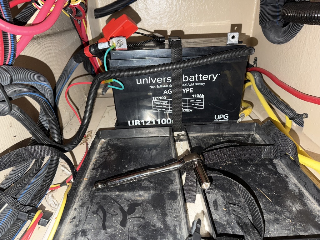

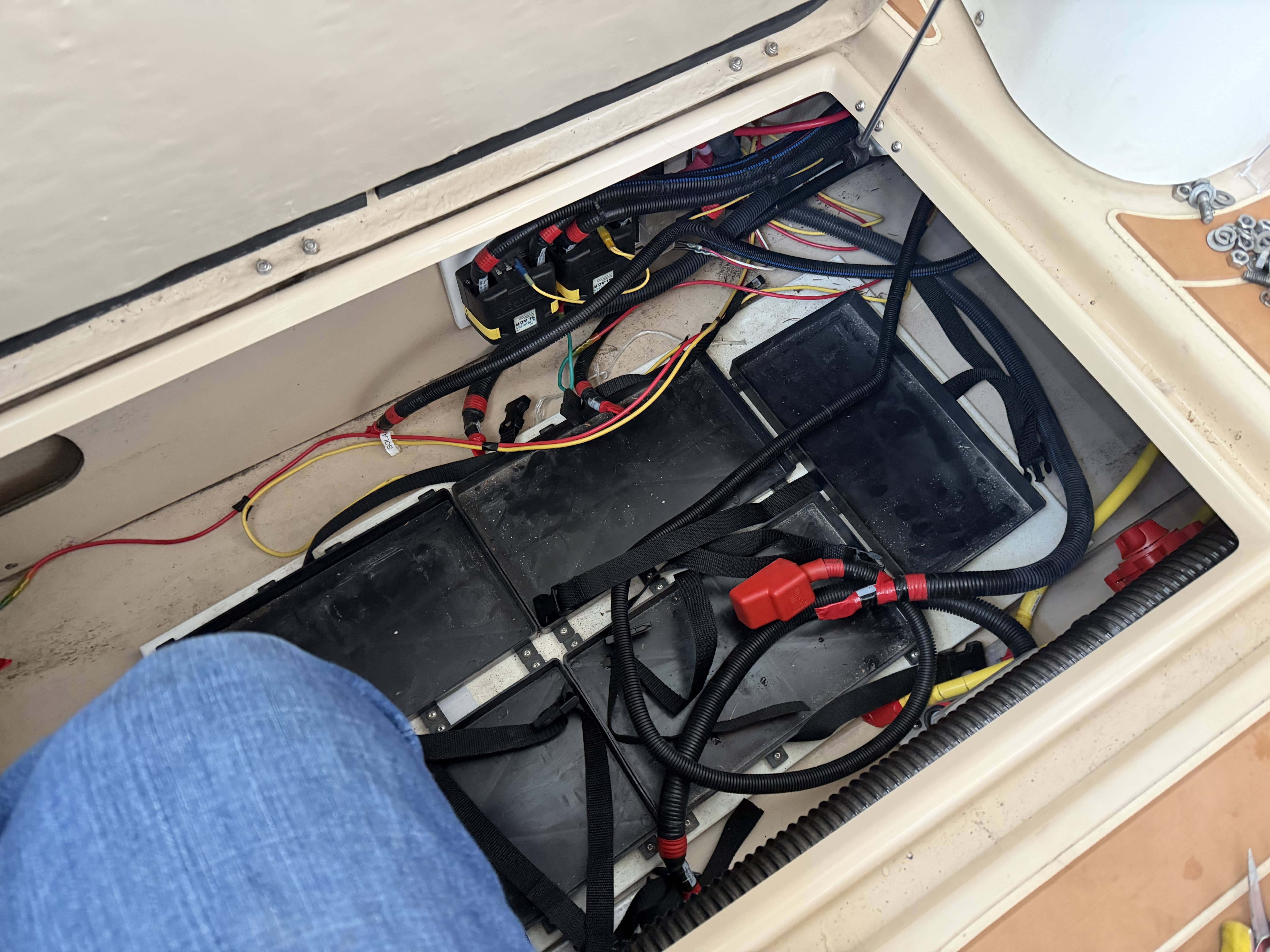

To get the engine battery, the 4 house batteries must be removed. I pulled out the first 2 batteries on the shelf. Then I removed the two screws holding down the starboard tray. Slide the remaining 3 batteries back about 10" so I could get the third, house battery, out (the one on the inboard side to expose access to the negative post on the engine battery). Then I could reach the negative post on the engine battery (it has a short lead). disconnected it. Then I was able to pull the tray with the remaining 2 batteries all the way out.

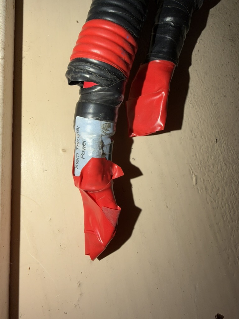

Note: Before moving the shelf (made of starboard), use a sharpie to draw an outline on the two corners. That will help align the holes in the screws back to their original position when you slide the tray back into place. I sat in the port laz, and used my feet to push the battery tray with the batteries back into place with only 3 batteries in place. I also use electrical tape over all the connections I remove, to help prevent an accidental short from occuring with all the cables hanging loose.
The new battery also needs 5/16" posts to fit the existing cable lugs on the boat.
