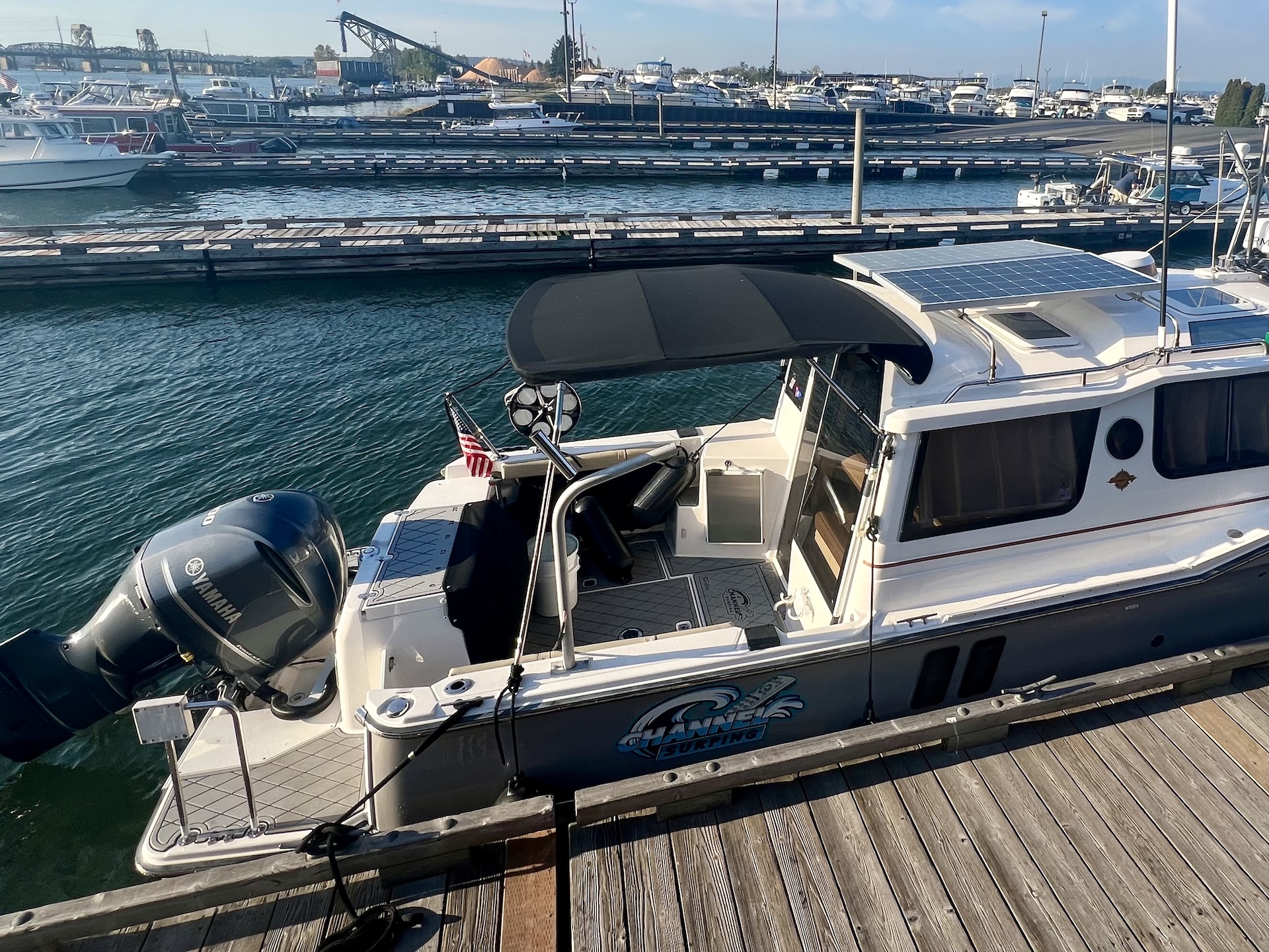

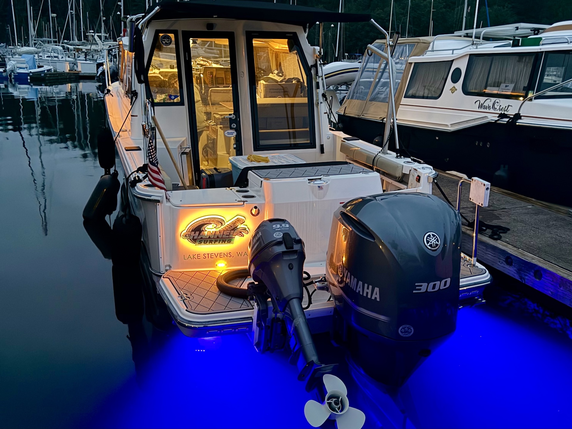

However... when I thought I only needed 1 or 2 pieces.. turns out, I needed all the pieces as they'd all failed (4 year old decking). So we pivoted to SeaDek, they had better designs, fish ruler, were willing to put our boat name into our decking, and just made the boat look even better. The way BlueSeasFab templates the SeaDek decking, I expect to get 7-10 years out of this EVA foam decking. The reason why is explained in this follow-up video.

I'd recommend taking this opportunity to get creative and make your boat "pop". 😎
