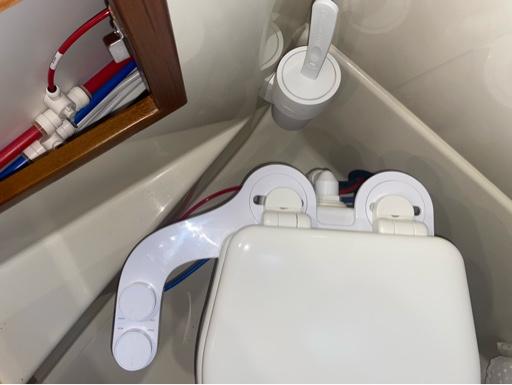

On R27OB.
I used this attachment:
https://myomigo.com/products/element-plus
Which is non-electric and taps hot and cold water connections. Lotsa other options if you don’t care about warm water. But warm water is nice.
It fits the Raritan head fine. The attachments hang over the back a little but don’t obstruct anything. No problems with, um, aim.
I tapped the hot and cold freshwater tubing behind the locker door (so convenient!) w some valved quick connect fittings and ran new tubing back through the port beneath the head. I adapted the fittings that shipped w the bidet to connect the bidet to the new pex lines.
Also provides fresh water for flushing. Seawater connection lost prime for an afternoon and this came in handy.
10/10 would recommend. Just don’t turn temperature knob past 2 o’clock…
