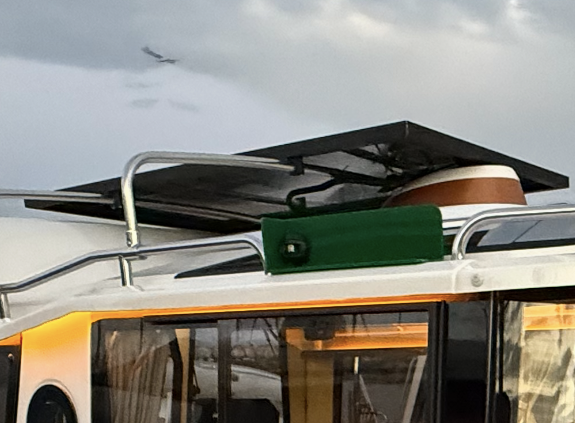

I installed a 300W bifacial panel from BougeRV in place of the stock panel. It was almost plug and play on my 2024 R25 LE. I selected the panel because its max open circuit voltage was within the limitations of the factory Kisae DMT1250 Abso 50 Amp DC/DC charger. I did not want to install a Victron MPPT 100A charger. Maybe I will someday if I add even more solar. I used the mounts from the old panel. I think they are Seadog.
The panel has been great. I leave house power on at all times and never need to turn on the battery charger unless we have a long stretch of cloudy weather (uncommon in Southern California). The panel keeps up with the fridge and all 24/7 house loads. I leave the Garmin and associated electronics "sleeping" so they draw minimal power.
Even with relatively smart battery chargers I question whether it is a good idea to keep the shore charger on with lithium batteries 100% of the time. My unproven theory is that relying on the solar panel 99% of the time will add longevity to the house batteries.

Ha! The “almost” was that the factory panel is hardwired, so I had to cut that and add MC4 connectors to plug in the new panel. A bonus is now it is literally plug and play if I want to swap this panel or add more.
