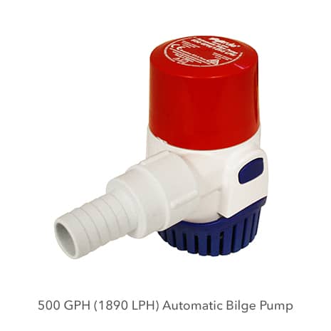

Hello...I've checked all past threads on the subject of a non-working bilge pump, but in my case the pump has worked intermittently and now not pumping out. It is running when it senses high enough water or I use the manual switch on the panel so it is running, it's just not pumping water out. I think it may be a clogged impeller. My problem is that the pump is impossible to get to. My manual says that it is supposed to be a Johnson pump, 750 gph, but as you can see in the attached picture, or barely see anyway, it looks to me like a Rule pump with the blue strainer bottom. Also, there is an oval white pad of some sort directly on the bottom of the bilge...could I be looking at the original location of the Johnson bilge pump and for some reason the pump was replaced (by the previous owner) with a Rule pump and placed in the location that it is farther forward under the transmission? My question is, can other Ranger 27 Classic owners weigh in her and tell me if their bilge pumps are in this location and if not, where? I have not attempted to disconnect the discharge hose and see if I can wiggle the pump aft to attempt to clear the impeller. That is my next step. Thank you all in advance to any response to this.

I have an R31, and had the bilge pump in the same location fail twice. This looks like a similar pump to mine, it's the Rule model 27SA, which turns on every 2 minutes to check for water, but doesn't have a standard float switch. You said yours turns on when it senses high water, so perhaps it has a standard float switch model, which is the 27DA - they look the same.
Either way, despite it not looking like it can be removed from under the prop shaft, it can on the R31, it's just really annoying. Hopefully yours is the same on the 27. Good luck.
Thank you for the info and your experience, watson1987. As a follow up, I was finally able to access the pump. As you warned, really annoying! As it turns out, it is a Rule 27DA with a separate float switch. No Johnson Pump. Not sure if the previous owner changed it or if it came from the factory as a Rule. Surprisingly, it was not clogged and is working just fine. However I have since been told by another source that the problem might be "too much head pressure" in other words, water that is held in the line by the check valve is too heavy for the pump to move when it starts to pump. Therefore, it is running but just not strong enough to push the water out of the hose. There is a check valve in line where the hose starts at the pump and I'm wondering if I remove it and install a check valve farther down the line where it is not running up-hill, whether or not that might work better. Has anyone else experienced this?
