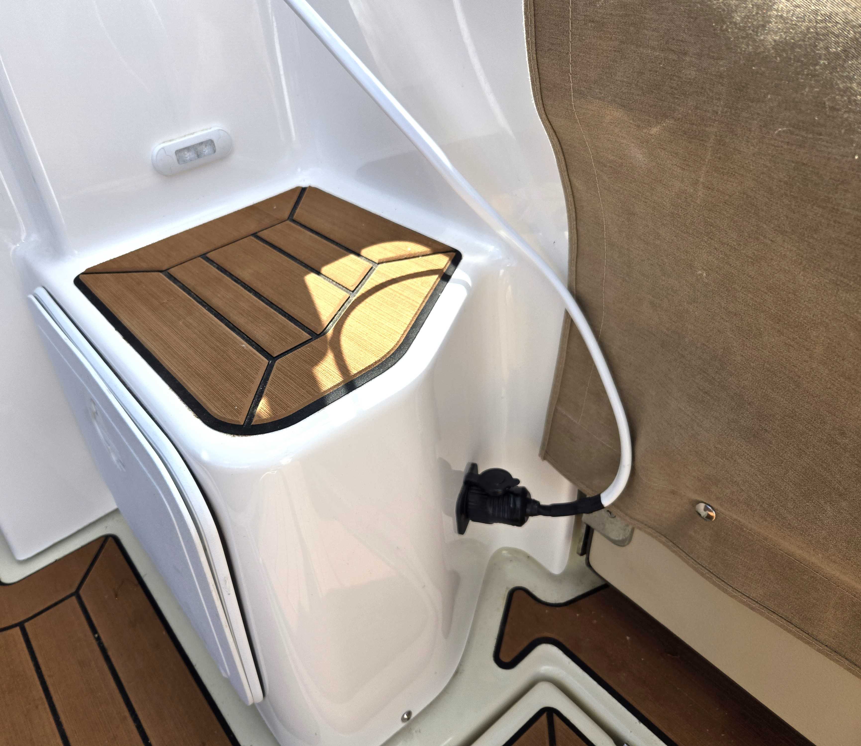

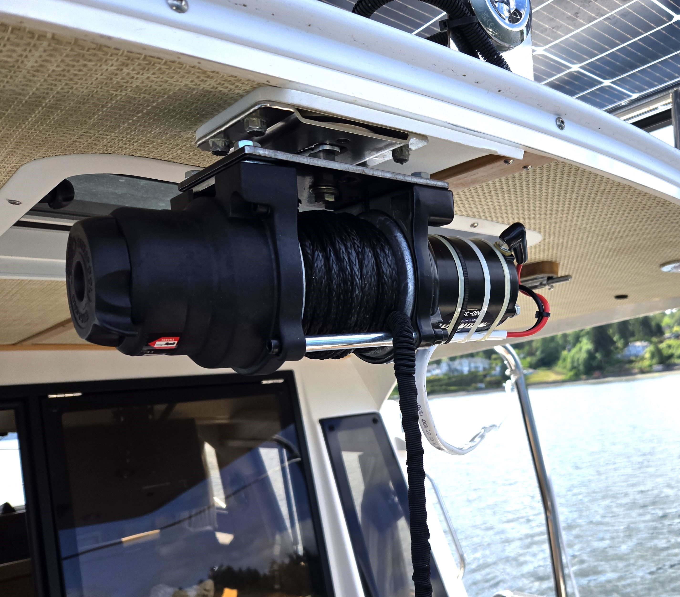

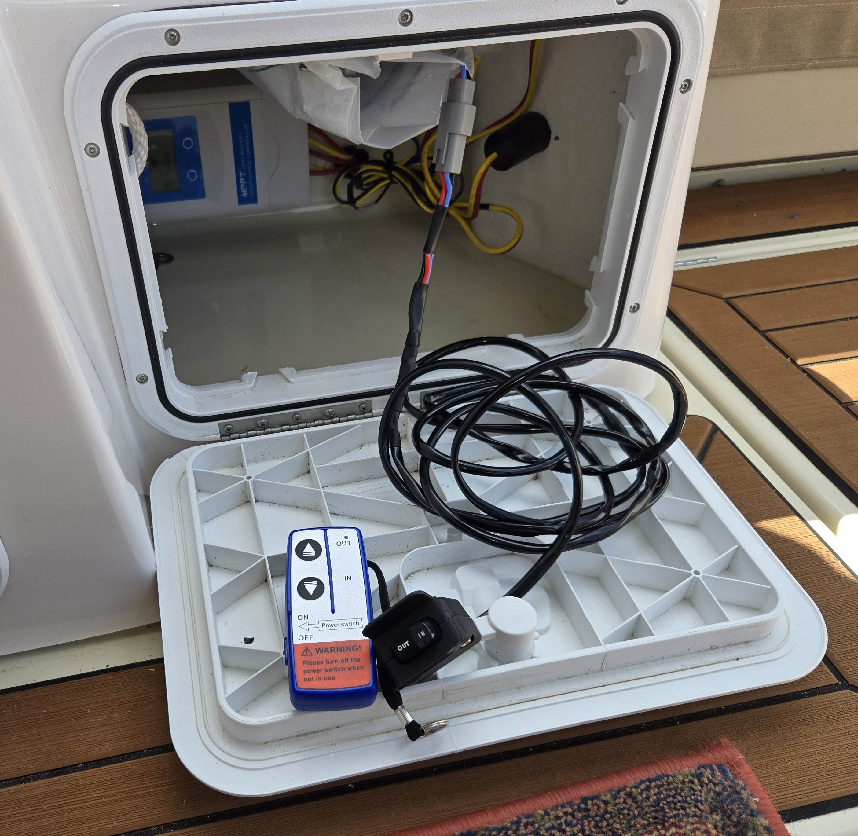

I came up with an electric winch setup for my factory 8' dingy. I plug it into the outlet for the starboard downrigger. I had to design the control circuit so it would mount out of the way to the top inside of the storage compartment/step. It has a removable wired switch and a remote. I was able to modify the existing davit mount in order to accommodate the winch. Everything is easily removeable for storage when not in use. Now, no more cranking the old come-along!

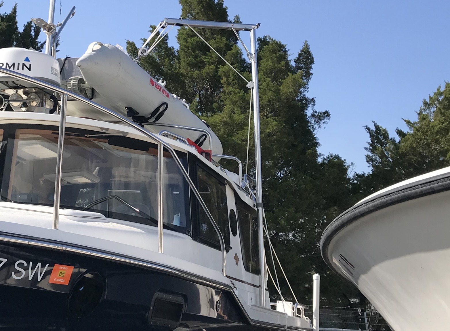

Above pic is a Garhauer dinghy lift on a R23…..super well made and reasonably priced. I eventually cut a foot off the top. The whole thing easily breaks down by lifting off the base ball socket and pitching the assembly back towards the cockpit via the rotating aluminum ring attached to the cabin housing. (note i had a specially made reinforcement gusset where the ring attaches to the cabin housing) The upper section sits in the tube and can also be pulled out collapsed. It will all fit in a golf bag.
Once the dinghy is lifted to the needed height, just walk to the other side of the boat and the dinghy will swing around on its own. The largest soft dinghy i had weighed about 70 pounds…i would say that’s plenty.

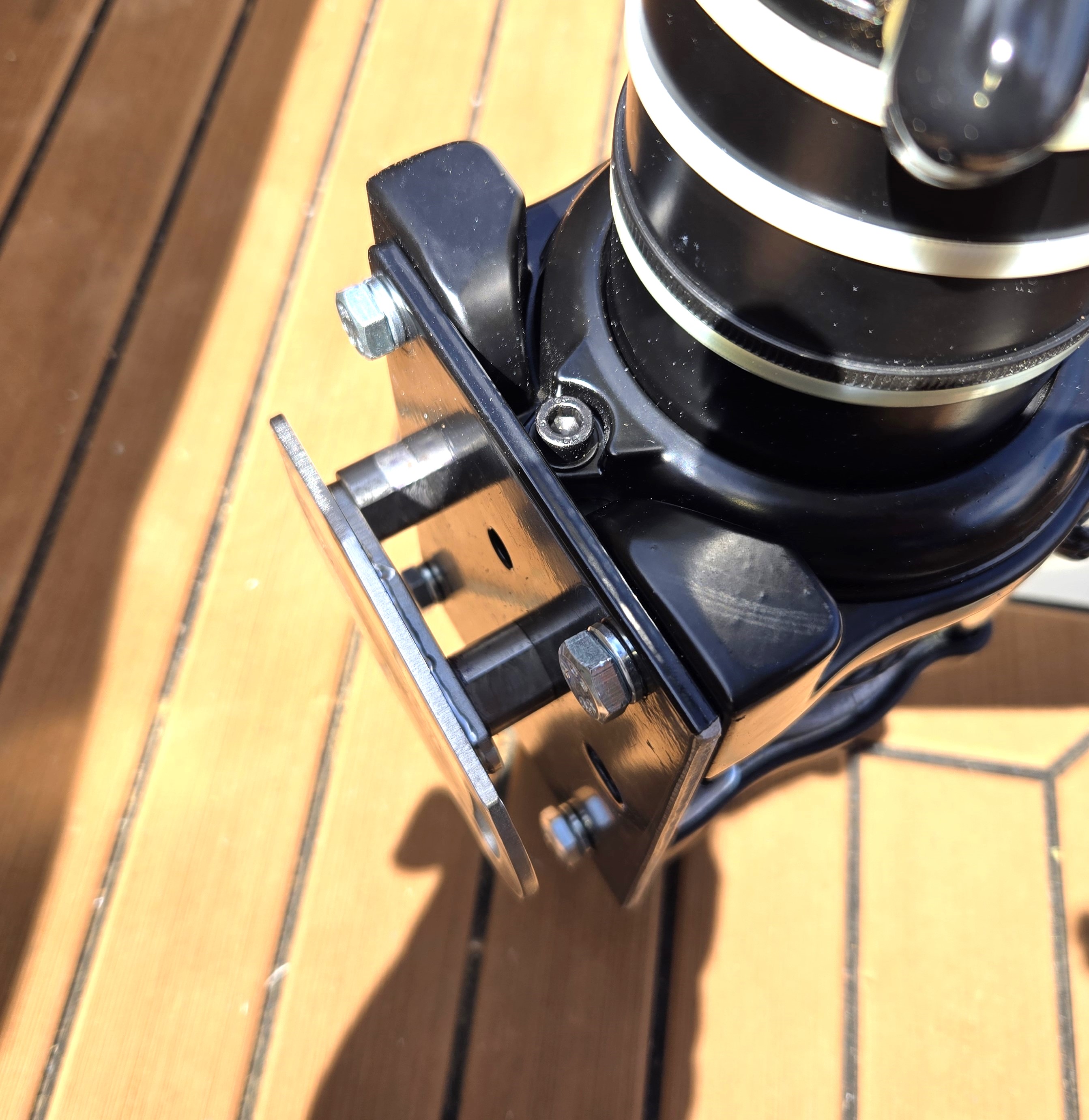

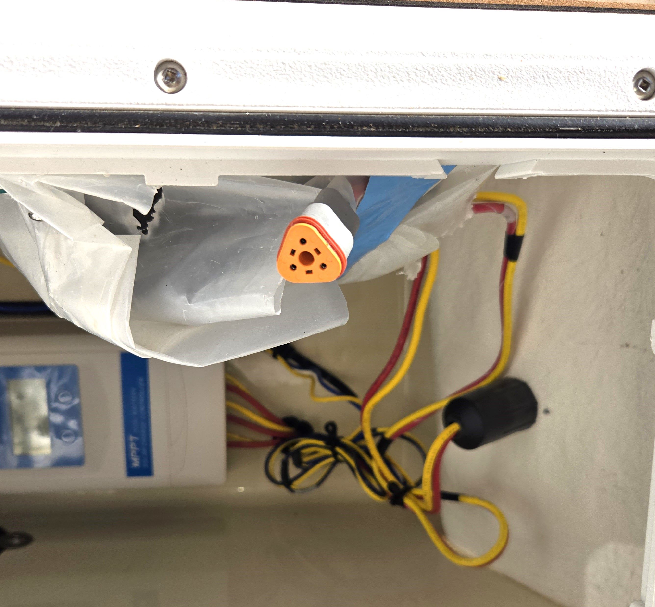

I got a 3000lb capacity winch from Amazon. It came with a wired switch and a remote. The first order of business was the switch. The switch it designed so the “hot” power lead exits the wire bundle somewhere near the switch itself. I needed all three leads to be the same length. I soldered on an extension was able to run it inside the bundle to get all three wires the same length. I attached a 3-prong waterproof connection so I could remove the switch when not in use. Next, I mounted the contactor, the remote receiver, an in-line 40-amp fuse and all the terminal strips etc. on a 7”x7” marine grade plywood base that I painted white. I slathered all the connections in dielectric grease and wrapped it in heave plastic before mounting it. The whole thing is very streamlined and the plastic sheeting gives it extra protection when utilizing the storage space. Next, the winch itself. I took the old davit plate from the original manual winch and was able to use it for the power winch by drilling two new mounting holes in the winch plate that match the studs on the davit plate. I also had to machine two threaded bushings to give enough clearance for the bolts that hold the davit receptacle to the underside of the overhang. I got some 10 gage marine grade wire for the power cord. One end of the cord was mated to a Scotty plug that fits in the existing outlet. A stainless-steel hook keeps the cord out of the way when in use. When not in use, the winch, cord, and remote fit nicely in the storage compartment at the head of the bunk in the main cabin. A little inconvenient but I like it for weight distribution.
Love the setup and we are working on having the crane installed. Can you share the origin of the black mounts the dinghy is resting on? It looks like they are affixed to the bars. Very elegant solution to creating a "seat" for the dinghy. Any information on those would be greatly appreciated! Thank you so much for sharing your system.
