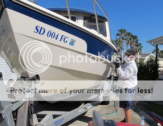

Tim was gone for the holidays and I did not feel like wrestling steel booms off the field sprayer, etc. on my own... So, I cleared space in the shop and brought the boat home... I spent most of yesterday swinging a screaming buffer (trying to at least)... I went over the worst scratches by wet sanding with 1000 grit until I could no longer see the scratch... Then I went over the sanded (dull and ugly) patches with the buffer using rubbing compound... Then I went over the area again using polishing compound... Then I went over the entire side of the hull with polishing compound to bring everything "down" to the same level of gloss - a rather dull gloss compared to the shiny gloss before I started... I finished the Starboard side up through an overall polish yesterday and today I am on the port side and about half done... The spirit is willing but my 'massively muscled' arms are not... (yeah right, 35 years of playing doctor leaves you with massive muscles - not)
