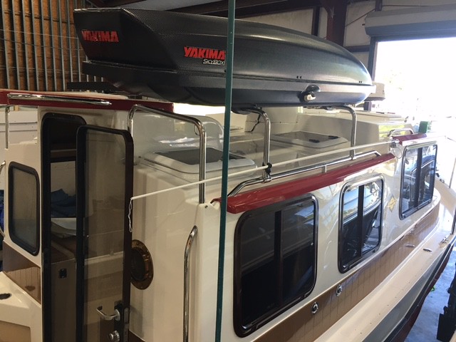

My dealer noticed that about 5" is missing off the end of my VHF antenna. We really don't know how it happened, but here's a picture of the result. I noticed the wires hanging down, but it didn't register with me that it was broken.
He's offered to put a new cap on it and says it would have a "minimal" impact on the performance.
Does this sound right? Unsure how costly or involved replacing the whole antenna would be.

I'm kind of amazed that something like this can be broken so easily. If I did it, you'd think I would have realized it at the time. I was unsure if they disconnected at the base of the antenna or there was more to it - great idea on the BNC connector BTW.
Think I'll see how the "repair" goes first and then decide if I need a new anteanna.
If your technical people are competent, you won't notice any change in performance. But, for 50 Bucks, I'd just replace it. The BNC is very practical and I can't believe any manufacturer/installer would not have put one in at the original installation.

My dealer repaired it by putting on a new tip. The internal wires were not compromised. Cost was $0.
