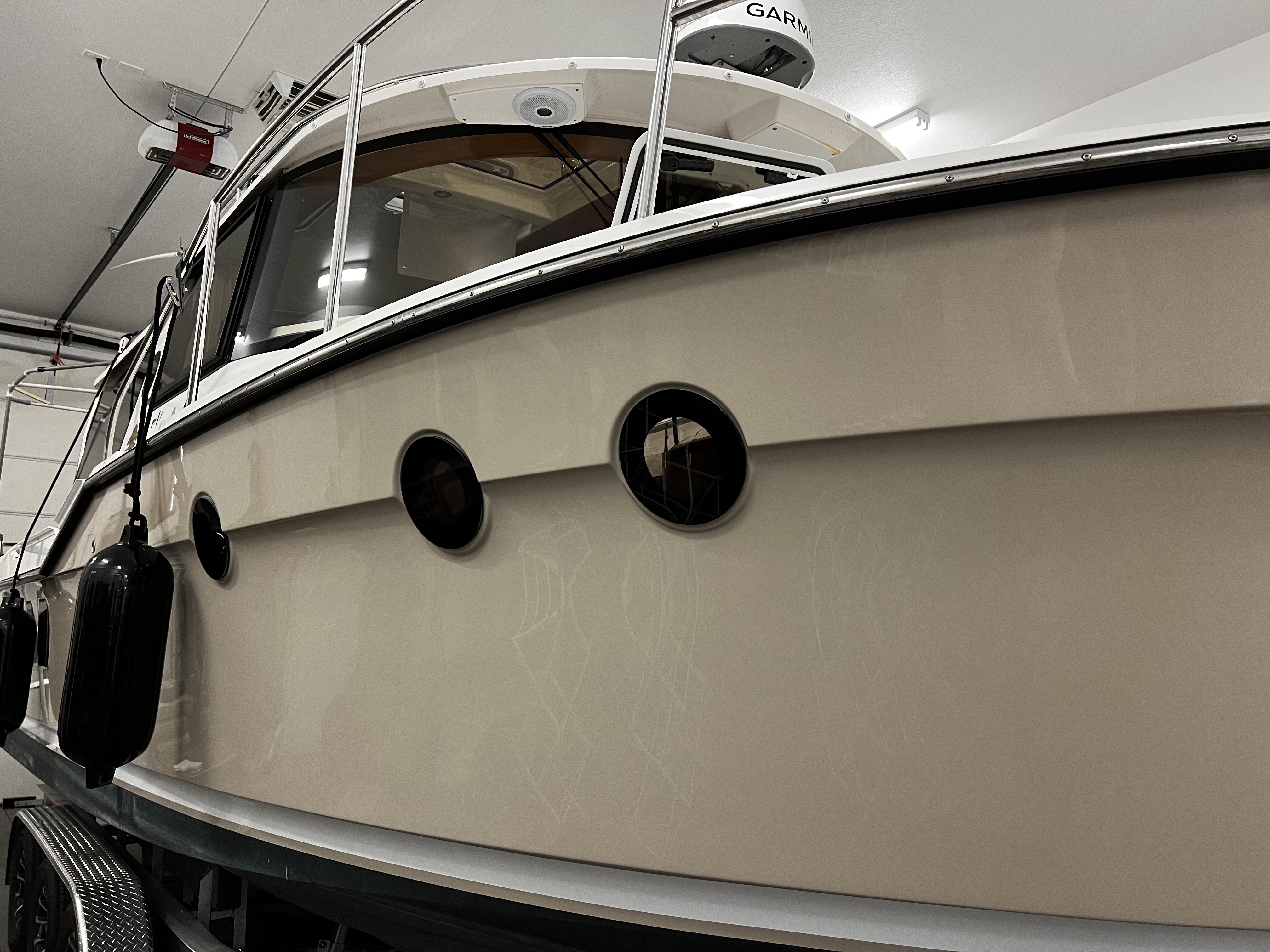

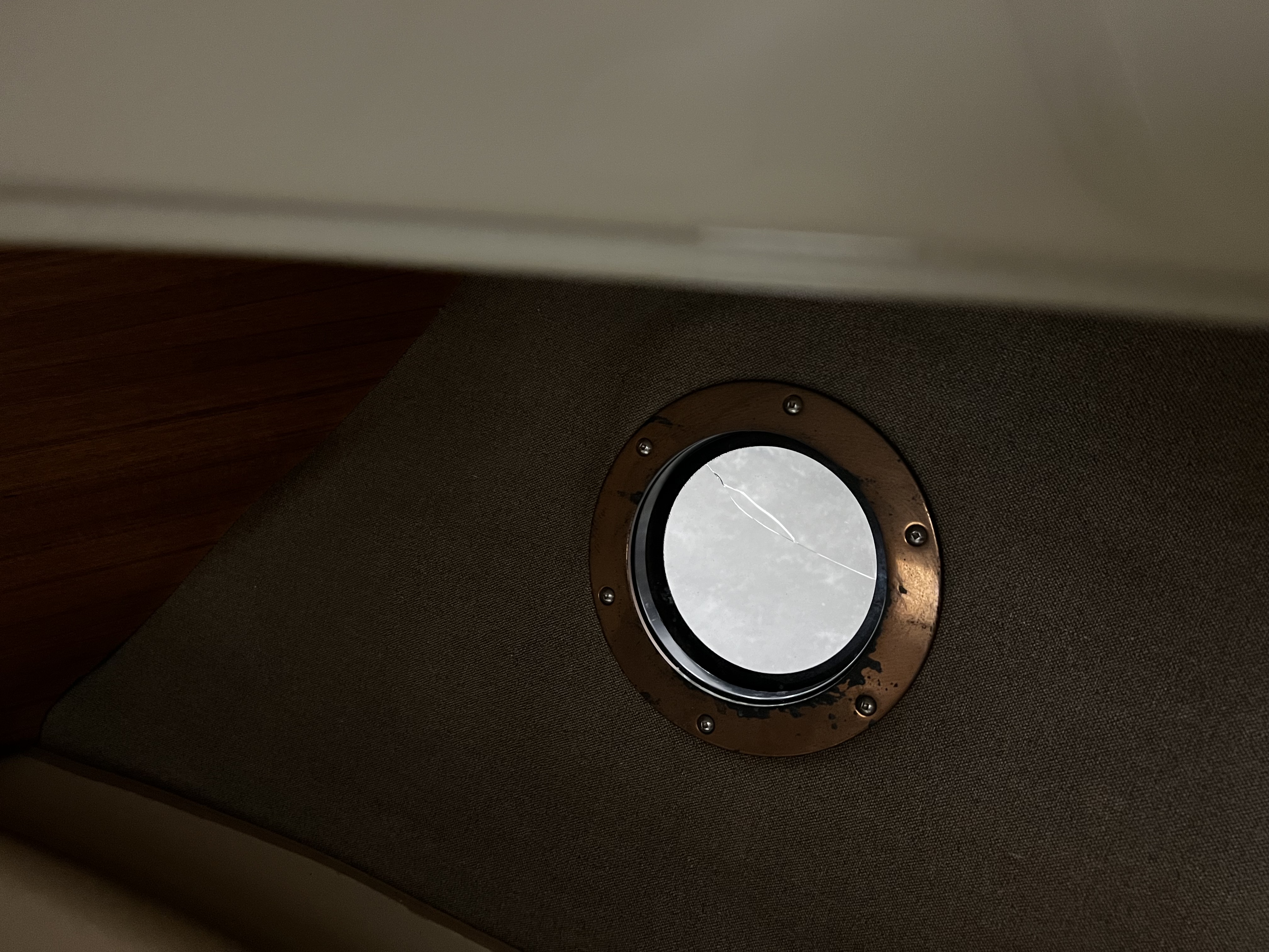

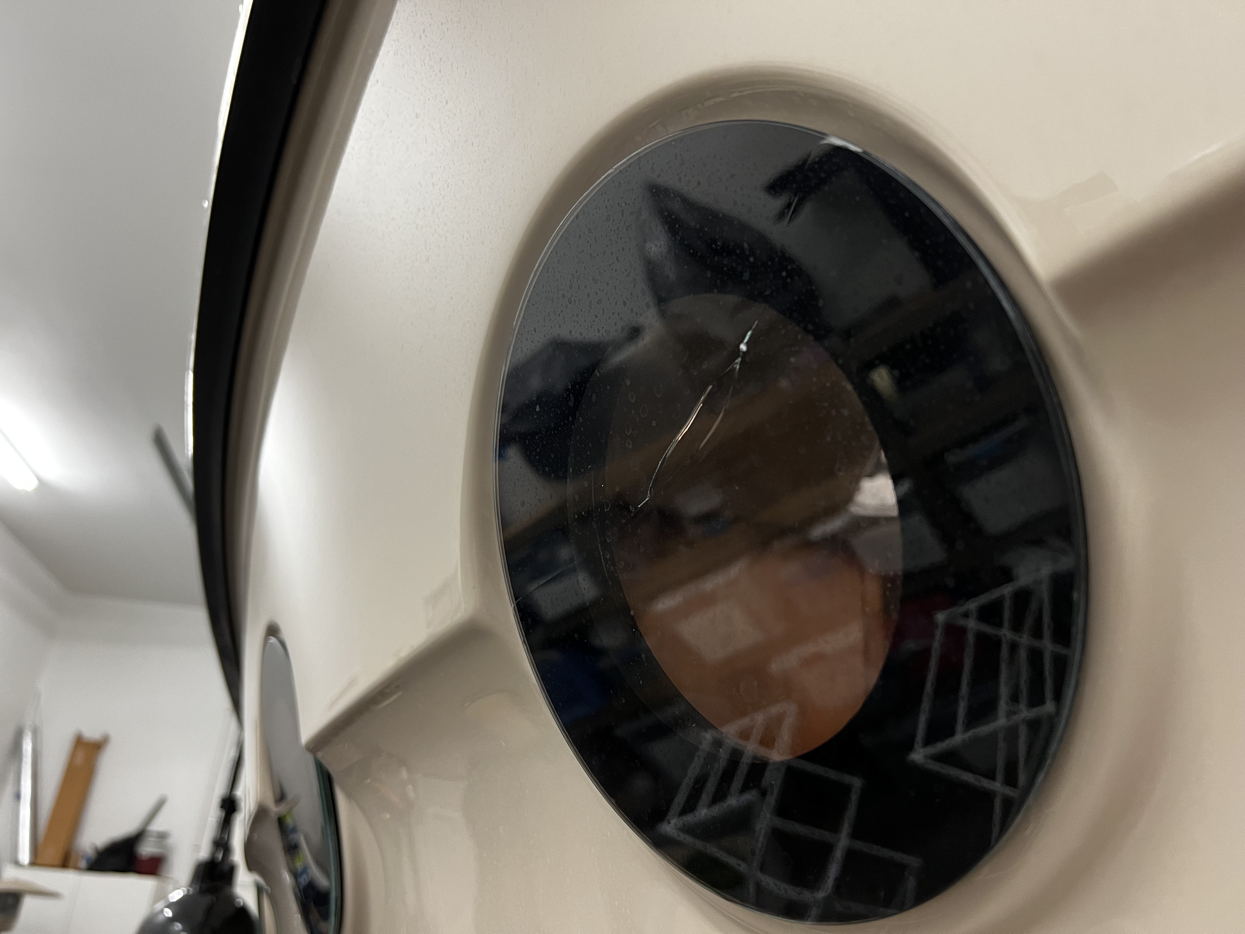

Picked up a rock chip while towing our 2021 R29 home to Arizona. Looks like only the outer layer is broken. Can I order a replacement and how is it replaced?

You will need to reach out to our parts department at parts@fluidmotionmarine.com please include your HIN for verification of the correct part in the email. The glass needs to be broken out, adhesive removed and then reinstalled. Any automotive glass repair company should be able to handle this.
