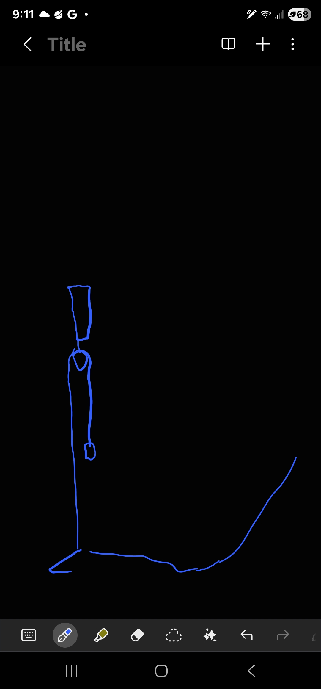

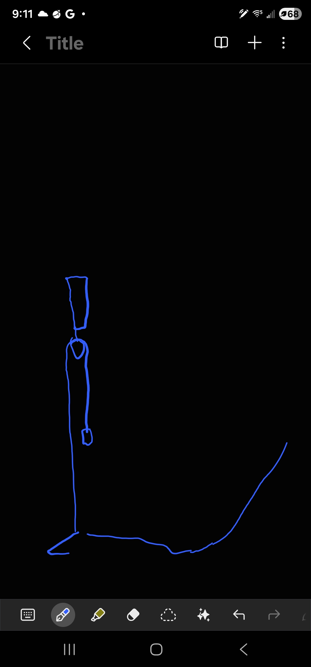

I liked the drawing! What's the process you use to deploy this anchor buoy setup? How much line do you have prepared for your system and what is the gauge of the rope? Thanks!Here is a picture (drawn by a child) of the setup I use. The rope passes through a $10 aluminum climbing pully, attached to a fender. The end of the rope has a 2lb weight on it. This allows the fender to stay above your anchor regardless of the tide changes. It also make the fender stand up straight. You also don't have extra line floating in the water to tangle with someones boat. If you have concerns on the tide and wind pulling on your anchor you have probably anchored in a inhospitable location. Like I said I only end up using it if I am in a crowded location or if I want it as a anchor release line because i'm in old logging grounds.
