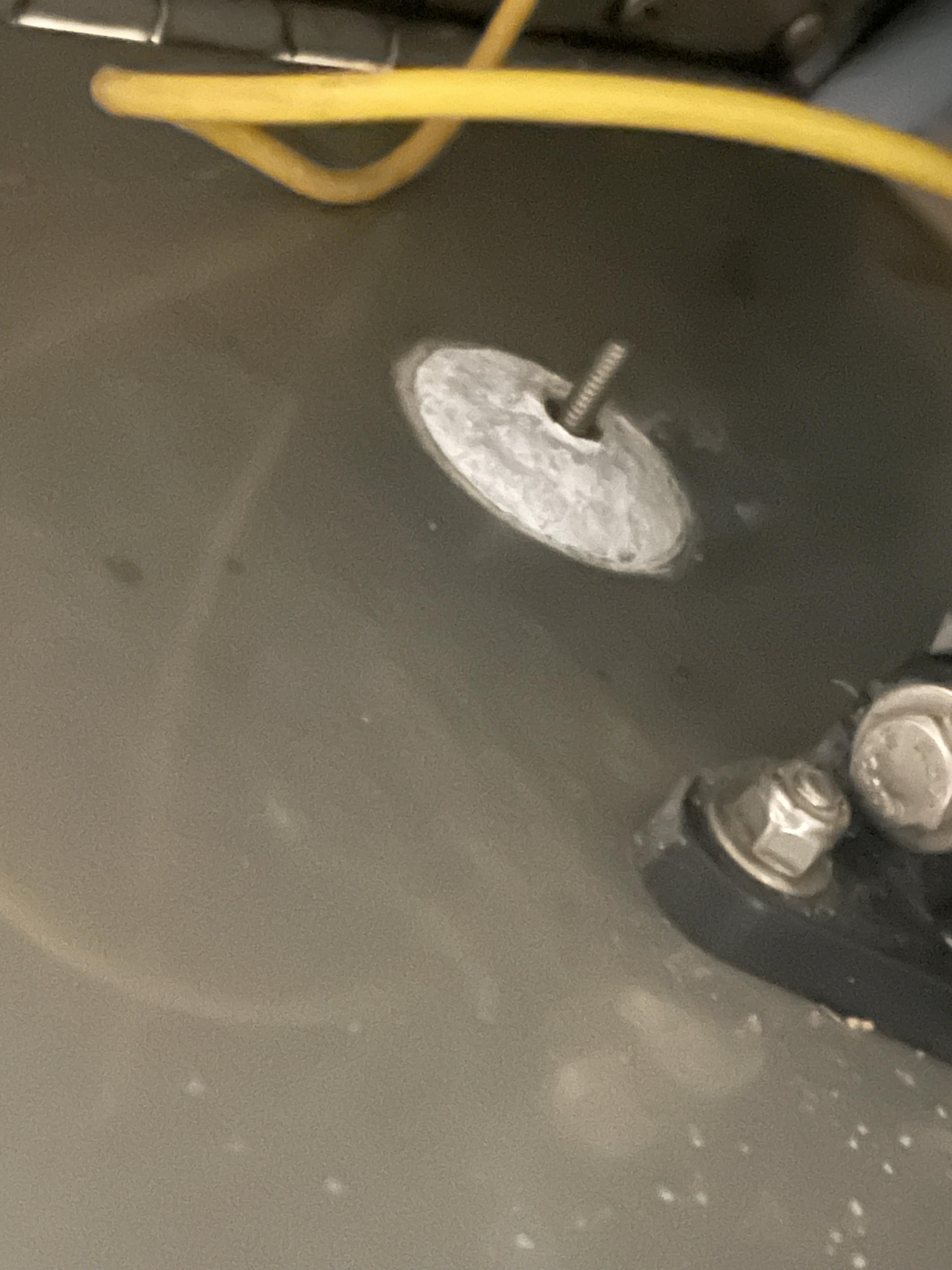

Put zincs on. It’s a 20 minute job with a good drill bit. We trailer our R-23 and this is after about 5 weeks total in brackish ICW water.
