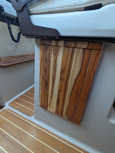

I wanted to share a solution I did to put a cabinet door where the wine fridge was. I got a teak board from Lowe's for $50 and cut it to size. I used an electric hand planer and hand sander to shape it to mimic the other cabinet doors. Put some teak oil and then some oil based poly. Bought some hinges and magnet latches and it turned out great. This is a massive storage area and will be incredibly useful.
Here's the link for the teak from Lowe's
https://www.lowes.com/pd/3-ft-Teak-Boar ... lsrc=aw.ds
Sent from my Pixel 6 using Tapatalk
It looks like when I uploaded the pictures it put some wavy lines in it. Those aren't really there.

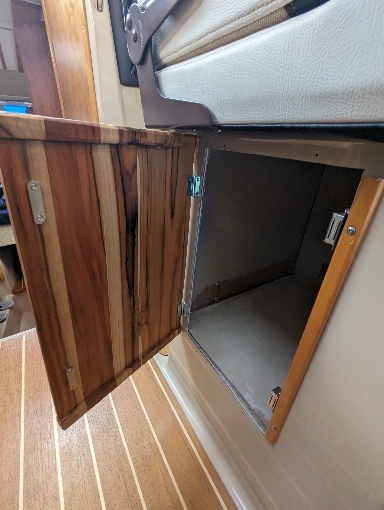

We used cabinet doors from a C-28 that had the drawers installed in the v-berth. Had to do a split upper and bottom because the fiberglass wall was curved outward top to bottom.
Doors are mounted to a 1” wide cherry frame that uses the original wine cooler frame’s mounting holes. That allows us to reinstall the wine cooler if a new owner wanted it instead of the storage space.
https://www.facebook.com/share/DA3HGd7T ... tid=WC7FNe
https://www.facebook.com/share/p/yZYrvC ... tid=K35XfP
Mounted one of these 4.5 watt (1/3 Amp) 12 volt motion sensing LED cabinet lights on the upper left side of the plywood back wall for lightening while the door is opened. Used the wiring going to the old wine cooler so it was easy to install.
