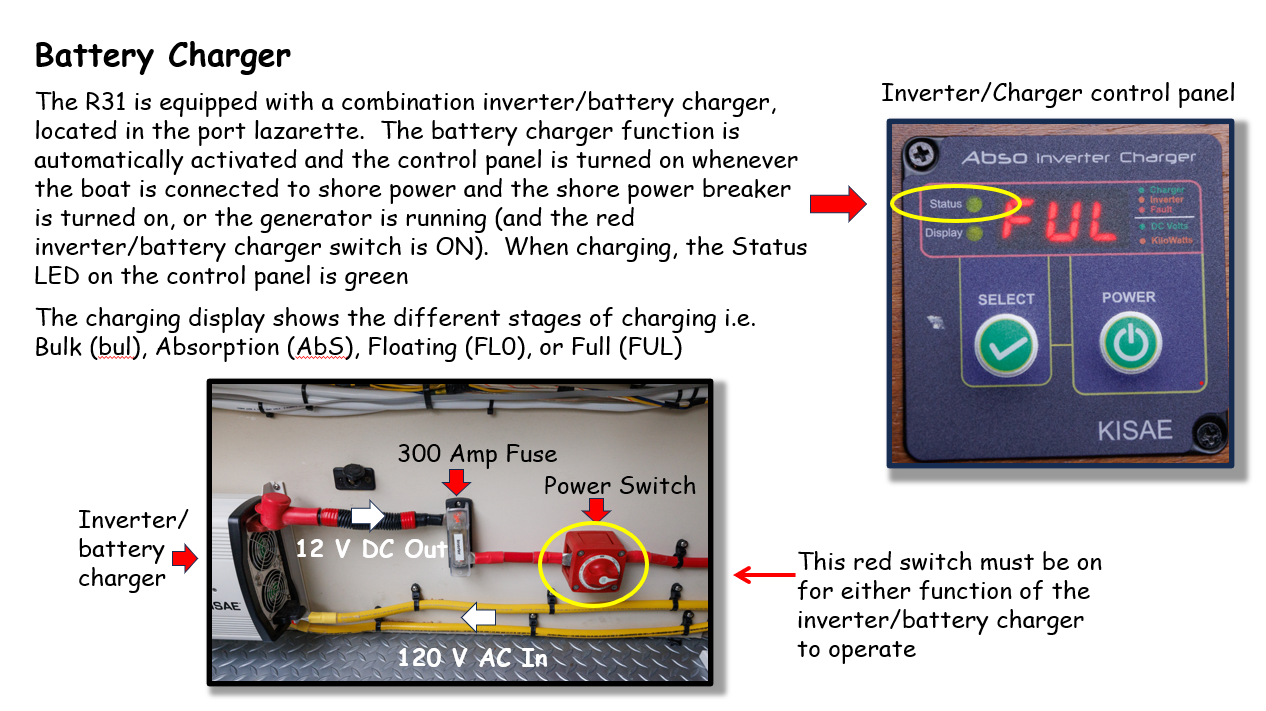

I bought a LiFePO4 portable power station, Dabbsson 3000L, and plan to use it when not at the dock and anchoring out, mainly to heat water and run a coffee maker in the morning. When I plug into the shore power plug on the boat with the power station, it's going to want to charge batteries too. I'm wondering if I can turn off battery charging for this situation? I have a 400W solar panel for the house batteries that will charge batteries just fine and I'll be installing a 440W panel just to charge the power station. My 31 is a 2017 and my inverter/charger is a KISAE 2000W IC122055. Thanks for any comments.
