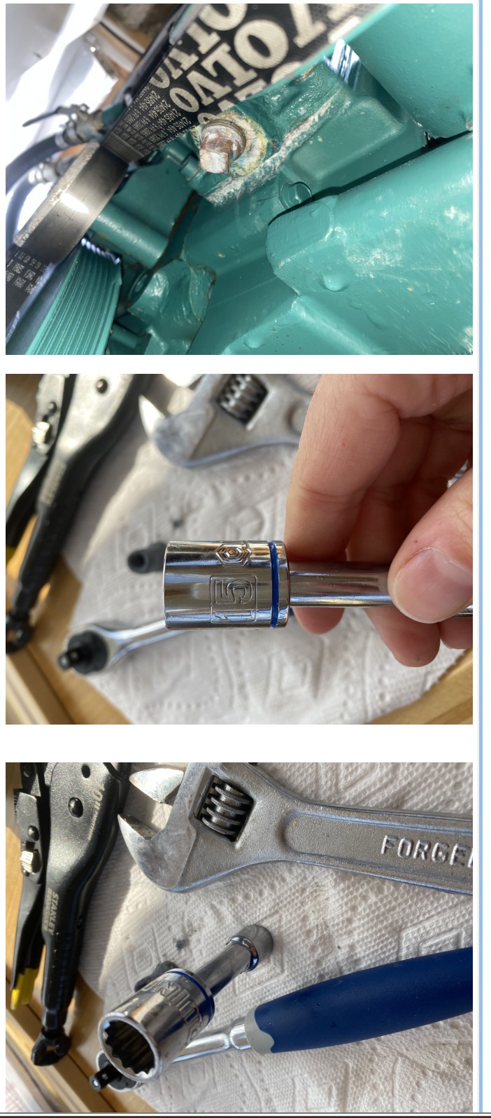

for the one at the back of the engine, I use a 15mm socket on a short extender. the 15mm will work with the square nut.
