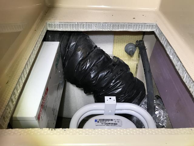

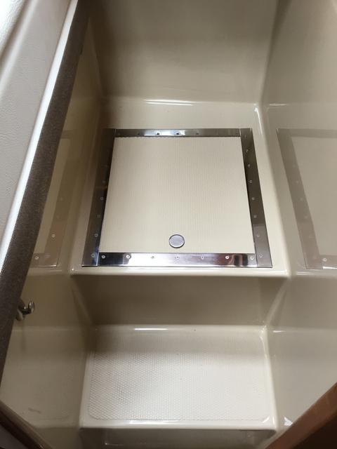

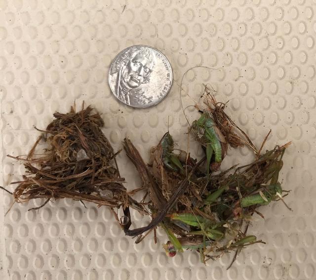

Last year, I had a hatch cut in the footwell of the port side seat to facilitate quick and easy access to the air conditioning condenser unit and water discharge thru-hull in case service was required. Today, that modification paid for itself. In about 10 minutes, I was able to pull the hatch (takes about five seconds), remove the A/C water discharge hose from the thru-hull fitting and clear out an insect nest from down inside the hose. After I cleared the nest, and with the discharge hose still off, I briefly started and stopped the A/C twice to flush out any remaining debris. I put a container down inside the hatch to capture the discharged water so I could inspect it and assure all the nest material was out.
Here’s what the A/C access hatch looks like installed:

Here’s the debris I pulled out using a pair of needle nose pliers and a hook tip pick. I put a nickel in the photo for scale:
Here’s a photo of the hatch opened and the A/C discharge hose removed:
