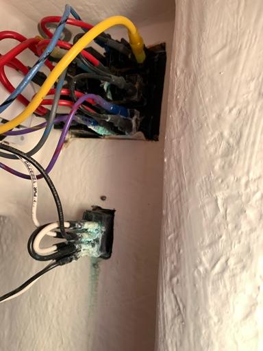

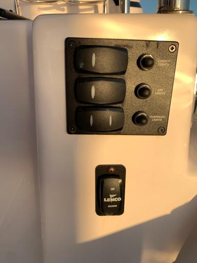

Who do I get corosion off of the contacts for these switches? The overhead light switch no longer works (and really won’t move). See pictures.

First try the easy solution (I swear by this stuff on my heavy construction equipment):
If it isn't dissolving away or the corrosion is just too much, you'll need to invest in the following:
  • Good Marine connectors
    A quality crimper
    A quality wire stripper
    Alleve/Advil/Tylenol - for the pains the next morning thanks to your new contortionist job
Please make sure the 12v power is off and that nothing is fused back to a 24/7 panel.
Also, inspect the switches with a multimeter while they are out.
-Sam

Its super easy....start with the Lenco trim switch.

Found out that the switch plate has no gasket. Thus, water has easy entry points. That seems to be an oversight on FM’s part.
