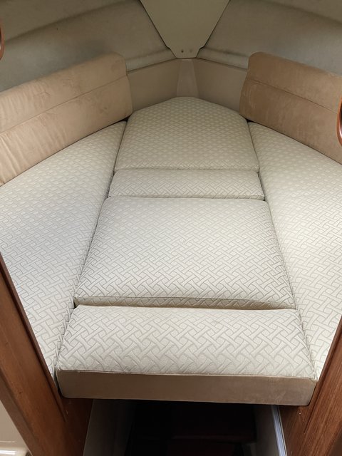

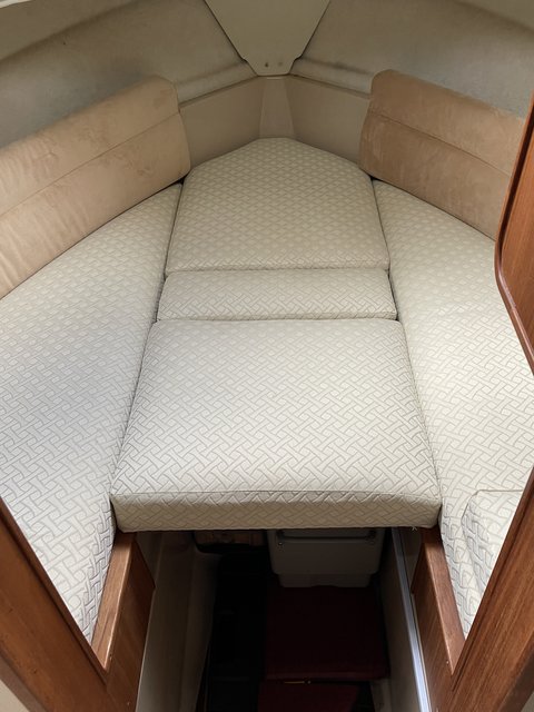

3) Cut one of the center cuddy cushions in half. Having only a half-cushion in the center crates a space at the entrance to the cuddy that makes it easier for us to exit. We swing our legs into the opening and step out of the cuddy using the step at the entry that is covered when using the full cushion. We don’t find it compromises our sleeping space.
There was not enough fabric on the cushion cut in half to cover the sides of the resulting two half-cushions so left over fabric from the bolster recovering was used on the sides of one of the half cushions. It looks great.
The unused half-cushion is kept in the cuddy in case we want the full cushion space. It’s mostly used as the bottom of a headrest created when pillows are stacked on it.

This is the cuddy with the half-cushion in the center:
This is the cuddy with both half-cushions in place.
