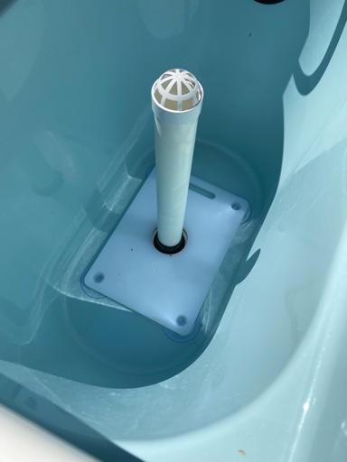

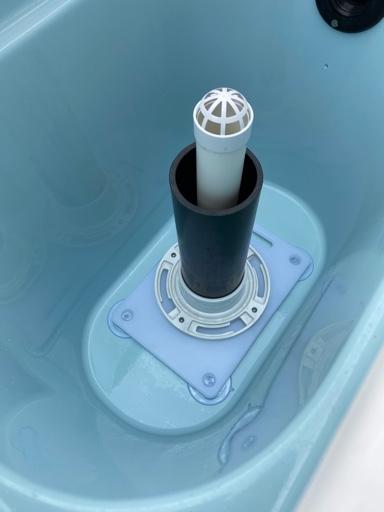

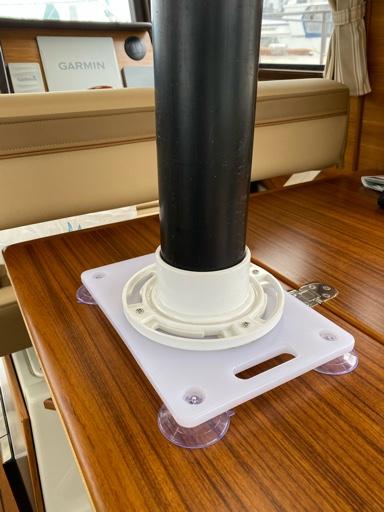

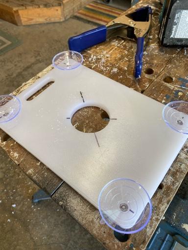

Here is a modification I came up with so that I can change the water in my R27OB bait tank without losing any shrimp down the drain and without any shrimp blocking the drain when I go to reinsert the stand pipe.
