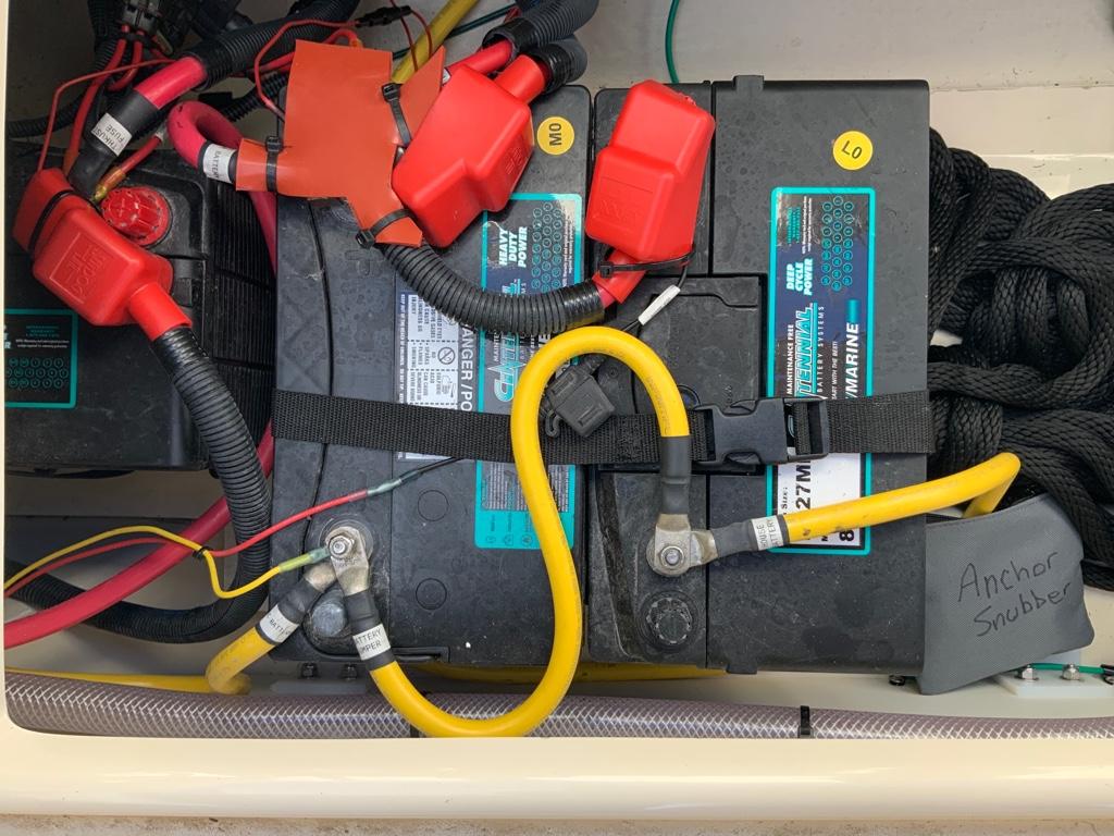

On my 2021, in addition to the 24x7 fuse block referenced above, the pod bilge pump fuse is in a in-line holder on to of the house battery bank.

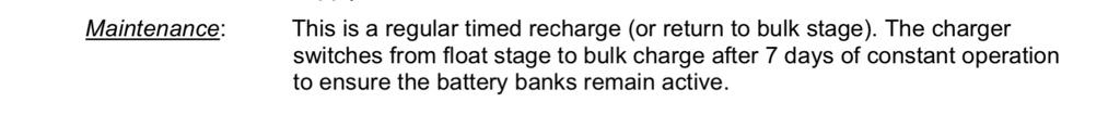

Not sure why you are only plugging in one day a week. the Abso charger has an automatic maintenance mode. From the manual:

I just navigated my way through this exact issue as I put my 2021 r23 away for the winter. The 24/7 panel located in the mid berth contains the two 5 amp fuses for two bilge pumps located in the lazerette. The engine pod fuse is located in line very close to the house battery.

For winter storage --today -I disconnected/removed (7.5A) fuses for all 3 of my 2919 R23 bilge pumps. They all have the auto cycle feature.. rotates in sequence -pod bilge then forward, then aft bilge. The fuse (7.5A) for the pod pump is where this forum noted- direct wired from house battery with fuse enclosed in sealed fuse holder on top of house battery.
