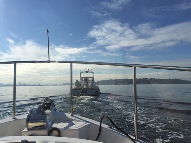

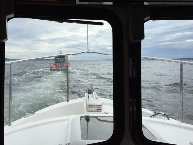

Unfortunately a man fell overboard and drowned off the coast of Everett on this day, there was a lot of activity on the VHF and all local Coast Guard “assets” were pre-occupied (understandably), and it took over 3 hours for a tow vessel to get to us (had to go through the locks - less understandable). At this point we had drifted way out into the shipping lanes between Edmonds and Kingston. It was relatively rough conditions and my wife and baby were pretty over it to say the least. Two huge freighters whizzed past us. Why did I give it so much gas in reverse!!!? :x
Eventually Dunato’s showed up, and in another 3 hours Dorothy was safely back to her home port. Thank goodness we packed extra diapers and baby food, we have tried to erase that 6 hour journey from our memory. And goodbye crab pots...
Kingston to Elliott Bay tow

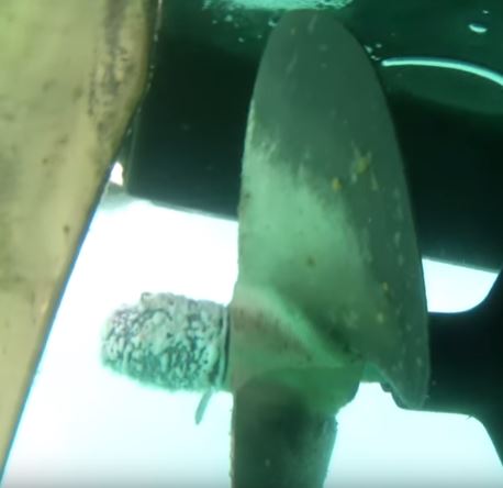

I put on a dive mask, and checked to make sure nothing was tangled in the prop.

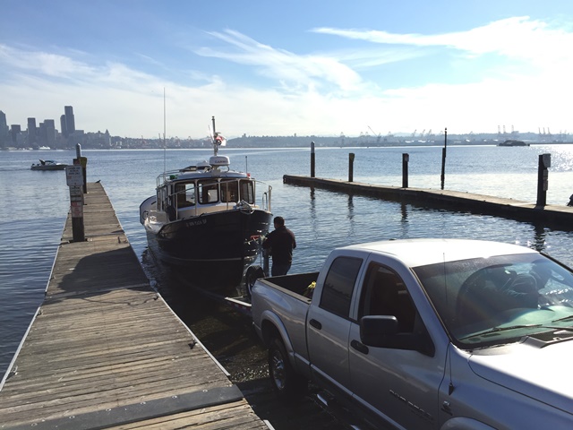

Kenny wanted Ranger to replace the transmission. So I scheduled another tow to the West Seattle Don Armeni Boat Ramp.
Nice day for a tow at least 😀
Ivan (with Ranger) and Tim (with Volvo) pulled the boat out of the water and trailered it back to the shop.
They had the transmission replaced the following day! Ivan replaced the zincs, pressure washed the hull, and took it out on the water to confirm all systems were functioning properly. The next day Ranger put the boat back in our slip at the marina!
