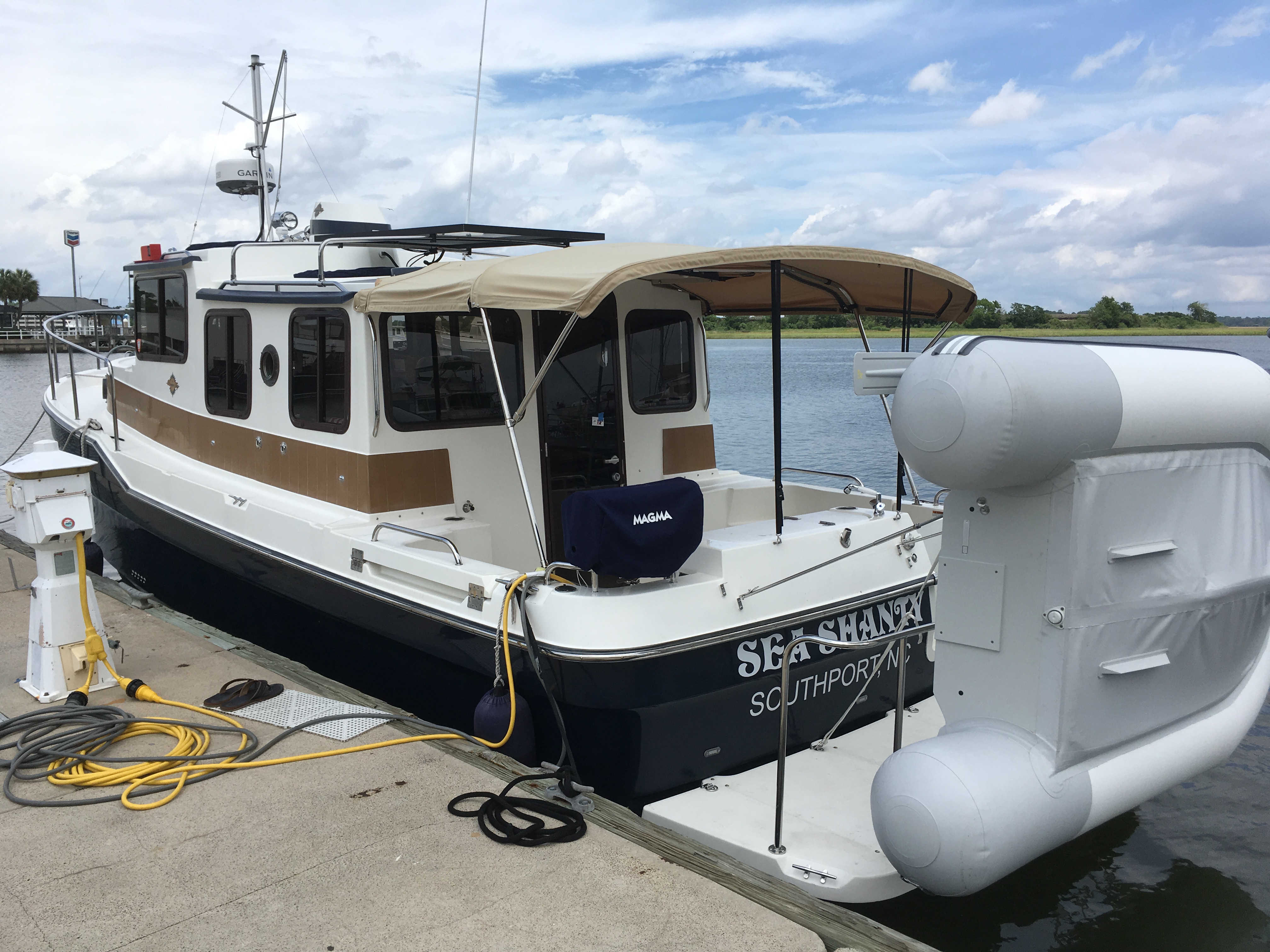

I did mine from scratch on a C-28. Even with all the right parts it’s a lot of work. Gluing the Weaver pads to the dinghy was by far the hardest part. Use the Weaver glue and follow the instructions exactly!
You want the Weaver davits that are 4” high and 4” out. And you need the pads that glue to the dinghy.
I have always used two stand off adjustable threaded rods to secure the dinghy to my boat’s stern. One of those two rods can be attached high up on the dinghy transom. The rod going to the dinghy bow area needs another pad glued to the dinghy. The dinghy will bounce around. You need both standoff rods at a minimum. I shopped around for sales and used on eBay and ended up spending about $700 for everything.
PS: Dinghy bow to starboard & dinghy transom to port side of your RT. Don’t center the dinghy on the swim platform. Shift the dinghy to the starboard side 4” or even 6” if you can. If you don’t, the lower port side tube will be dragging in the wake and splashing lots of spray back into the cockpit.

The dinghy will really, really bounce around on the davits. You want the upper half of the dinghy to be secure. My standoff rod clips on the C-28’s transom are bolted on using large stainless fender washers on the inside of the stern fiberglass. I highly recommend bolting the port side standoff rod to a clip bolted through the dinghy’s transom as well to get a really strong support that resists all the bouncing.
Once you see the dinghy bouncing around when you are at cruising speed I think you will agree.
In the attached photo you may be able to tell the davit heads are offset to the starboard side. It’s about 5” offset or so. My Zodiac Cadel Alu RIB dinghy is 82 pounds and 8’10” long or 270 cm.

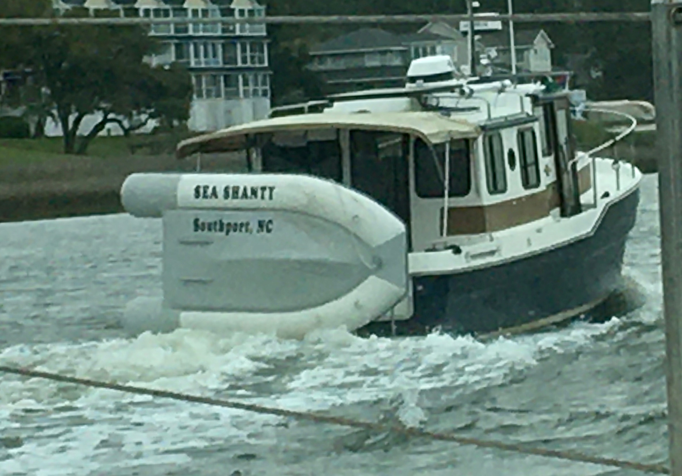

If you center the dinghy on the swim platform you will get a greater amount of drag and splash from the lower port side dinghy tube in your wake. If you cruise under 5 knots or so in calm seas this won’t be an issue. Faster speeds increase the drag and splash problem exponentially.
One splash solution is to “jack up” the lower port tube with a ratchet strap connected to your stern towing D-ring, over the swim platform and down to a hard attachment point on the dinghy’s lower transom. We do that on a regular basis.

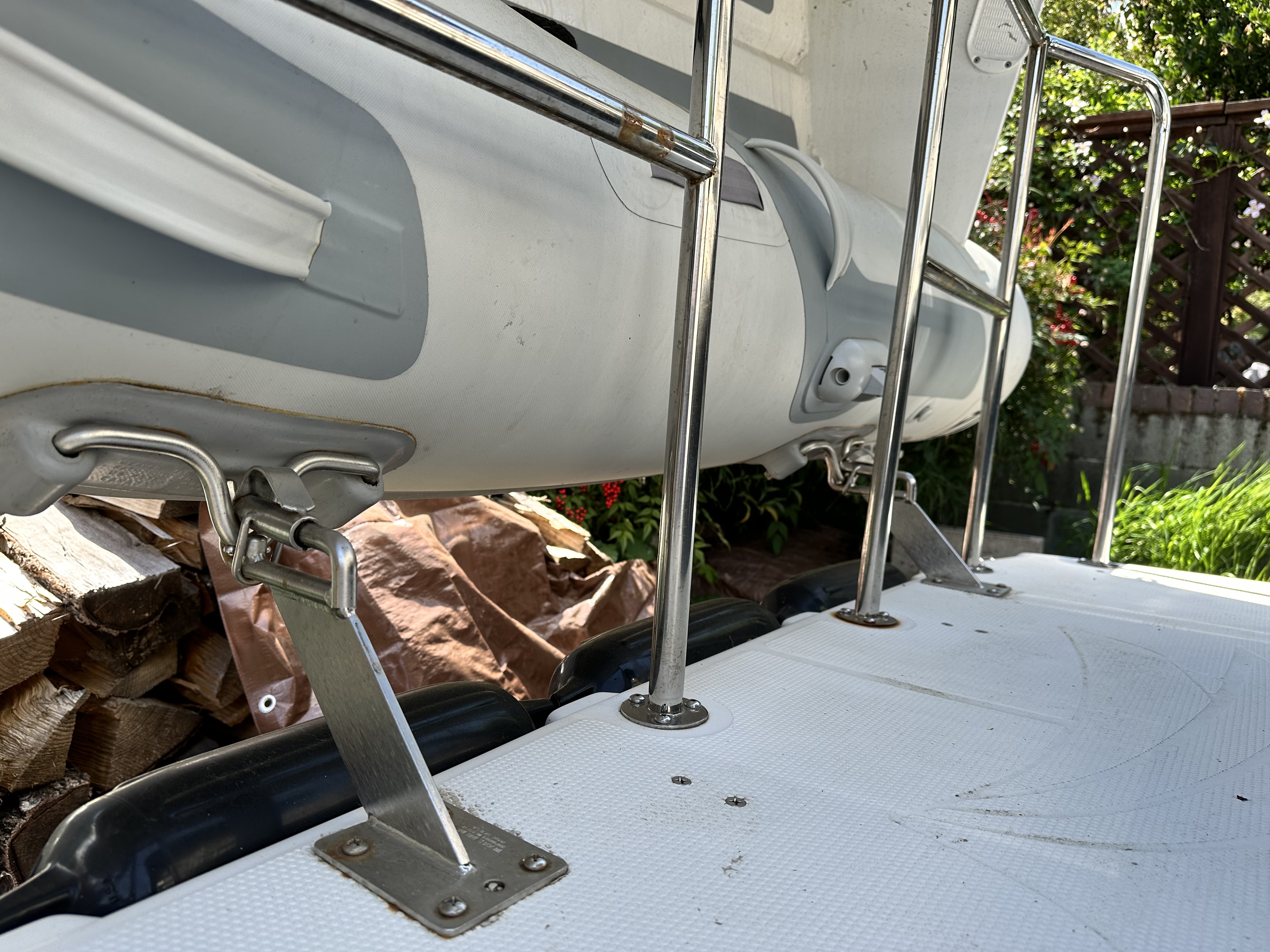

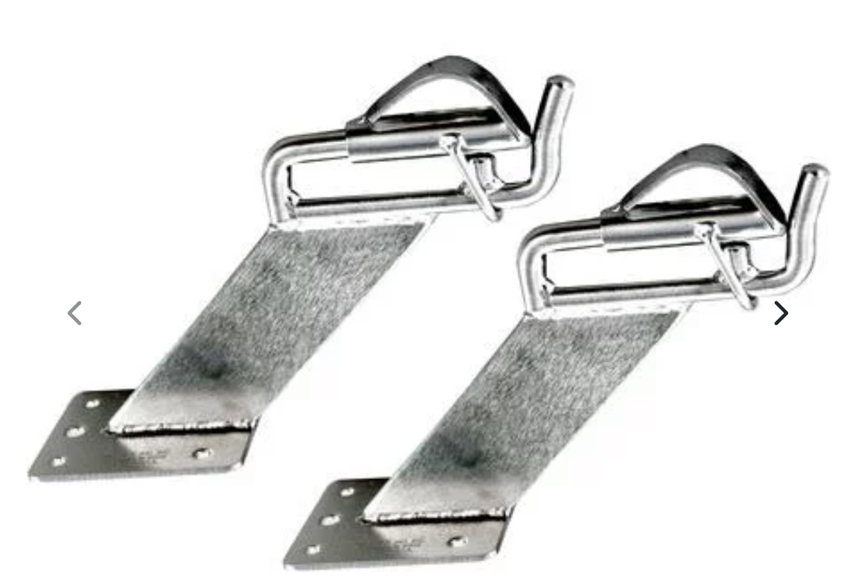

This shows the basic layout. Stbd stand off bracket attacked to the tube and the port standoff bracket attached to an L bracket through bolted on the transom.
This is the removable 4 inch up 4 inch out davit arm. It's good to have them removable so you don't have them in the way when coming and going with the dinghy. The brackets elevate the dinghy so your prop was doesn't impact the dinghy and keeps the tubes off the swim platform rails.
Here's the pad glued to the tube.
The port standoff bracket attached to the L bracket on the transom. I recommend you use the transom if possible because it gives you a good fixed point and doesn't rely on a glued pad on the tube.
There is the port attachment point for the stand off bracket. I used fender washers vice a backing plate due to space limitations. The upper L bracket is for stowing the stbd side bracket when the dinghy is off the davit. There's a second L bracket on the stbd side to stow the port stand off bracket
A view of the stbd stand off bracket in the stowed position.
